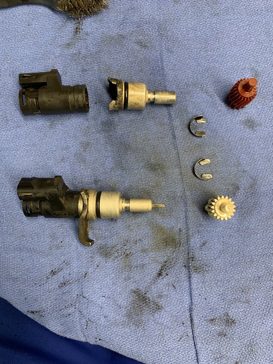

I had this issue and this is what I found when I pulled my speed sensor apart. Came apart in pieces. Fixed it and is super smooth now.
TY! Is this the speedometer parts down in/on the automatic transmission?? If so, is there any easy way to locate it?? I may attempt to fix my annual "cold weather-only" speedo "bounce"... Have read for years that some ?gear? needs to be cleaned/lubed *somewhere* on/in auto transmission.

That part is in the rear of the transmission. The U shaped metal retainer has one bolt connecting it, and the cable comes out from the rear when you remove the hair pin retainer. Put a pan underneath to catch transmission fluid.
