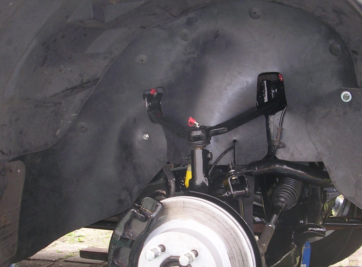

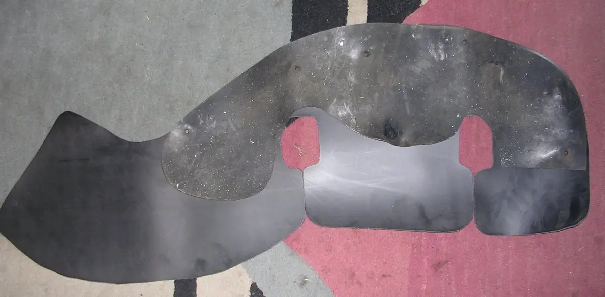

If you have a little bit of time and like durable stuff, then i would prefer selfmade splash shields.
They protect everything behind much better.
Those look fantastic!
Thanks, choose 4 mm thick rubber with texture layer inside, takes time to cut with
a metal shear and time to align. So unfortunately it's heavy to disassemble
if you want get to suspension parts.
But i do not like the "open inner fender" in front and rear, so i closed every gap
with rubber and flexible plastic parts.
Disadvantage, you did not look behind so often, rusty frame is the answer.
