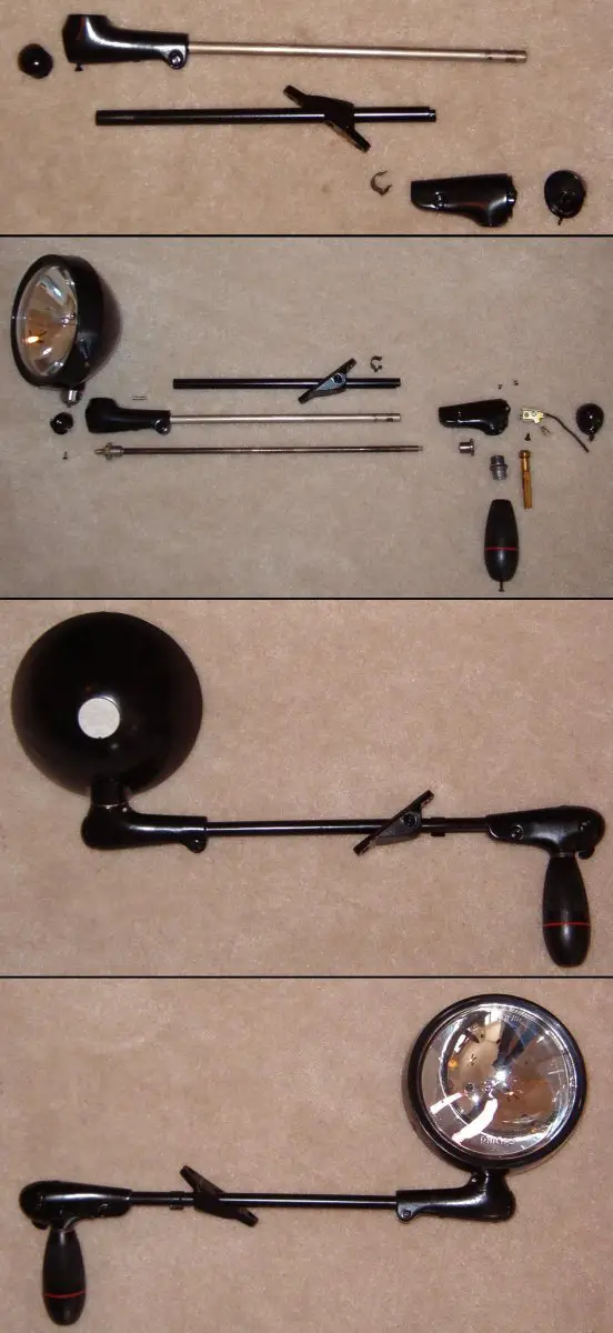

I have a 2014 Ford Explorer Police Interceptor with a driver side spotlight. The bulb is very old, dim, & dirty and had condensation inside. I want to replace the bulb, but I have 2 issues. First, I can't get the trim ring off. I removed the he screw, but when I tried to trunk the ring counter clockwise it won't budge. I tried wd-40,but it didn't help. The bottom of the ring is loose, but the top is still tight. Any suggestions? The other issue is that I have no idea where I could buy a replacement bulb, or a replacement trim ring if I accidentally break the ring removing it. I'd appreciate any & all help.

eBay has a lot of new and used Unity spotlamp parts. I also see LED bulb upgrades.
If the ring is metal, pull the bottom forward slightly, and then push straight up.
If it's plastic like this one - I don't remember taking it apart.
Regarding disassembly, there are a bunch of helpful YouTube videos out there from De-policify and others. I found the process and order of operations rather unintuitive, and would have had a real difficult time without their walkthroughs.
