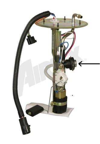

There seems to be a lot of misinformation on this fuel system and the "books" in question are the service manuals written by 3rd party companies...Or Ford mechanics who apparently have not seen this 10+ year old system...
Look at the arrow in the picture below; this is the fuel pressure regulator in the Ford returnless fuel system...There is no vacuum line to this unit...Ford does include a pulse damper which DOES have a vacuum line to smooth out the pulses from the fuel pump going to the injectors...
And this is the case no matter what engine is used in the 99 Explorer...

Look at the purple arrow...The pump is attached by a hose to the outlet side of the tube going out the top of the fuel sending unit...And here is the link to my pump purchase... And the electrical connections, fuel filter sock, hose, and clamps are included... All for $ 22 and change with free shipping...
