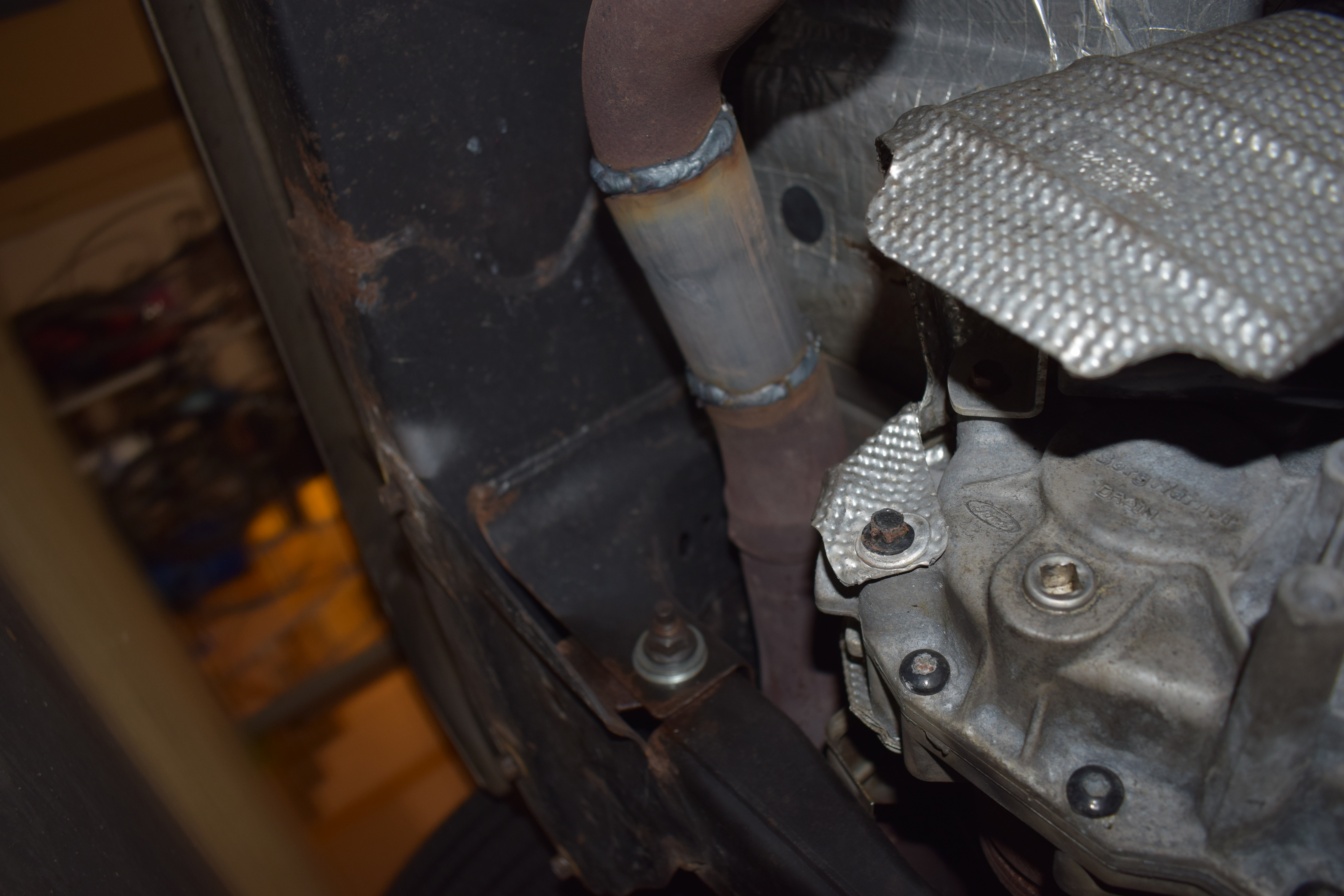

Wow, looks like the old pipe is inserting into a new collar and welded on. Looks like a arc welder was used as well.
I hope it hold on the rusty old pipe surface but at least a nice collar type repair. Not seen this done before.
