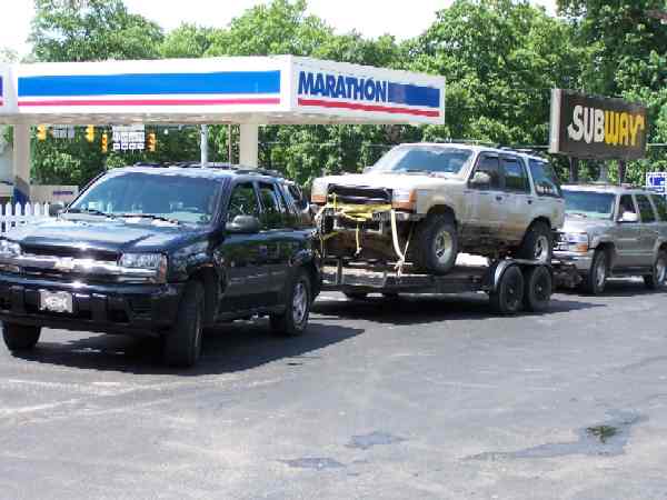

We regularly tow 7500 behind our Chevy Trailblazer with a couple of simple mods, so that size and type vehicle is not the limiting factor. Granted, a Super Duty is the preferred means (and a goose neck trailer at that) but the SUV type vehicle WILL handle a big load if properly prepped.
We're running 285 x 16 tires, K&N drop in filter, Amsoil everything, modified transmission shift valves, bigger cooler for the tranny, good hitch, etc.
