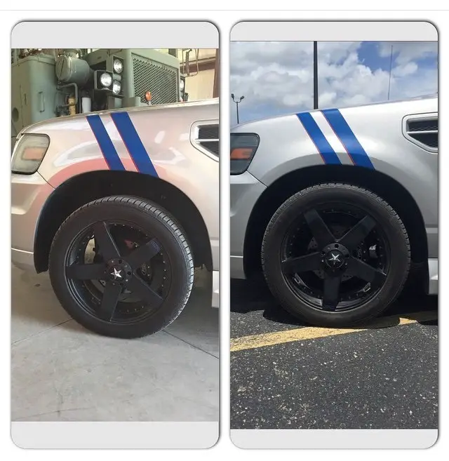

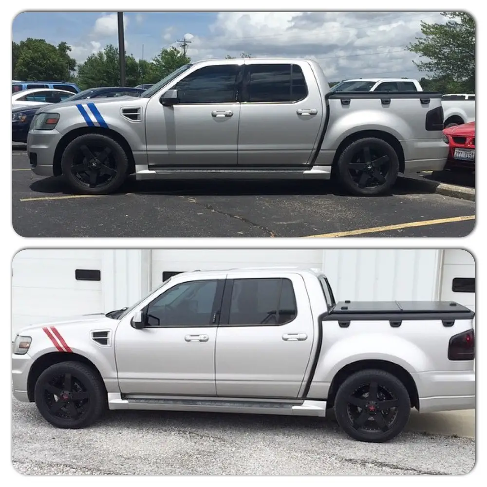

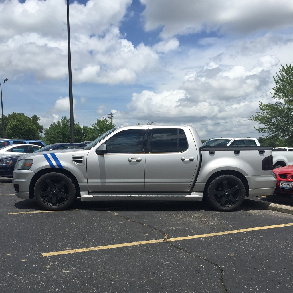

So I pulled the trigger today and cut my springs. I started with one and ended up cutting 2 coils off all the way around. It has a bit of a rake to it, but I think it looks good.

Thanks for sharing toddy and being somewhat of a guinea pig for some of us. If you dont mind me asking, did you have a shop do the work or did you do it yourself? If it wasn't too difficult, I may attempt the project myself.
I did it on my own, it wasnt hard at all. The hardest part was repeating the process twice. I started on the front and cut a coil, reinstalled to check clearance and then took it all apart to cut another coil off. The rear was actually easier than the front. Now that I have done it I could probably knock a truck out in 2-3 hours to include cutting the springs if there were no complications.
I have been taking the crappy bumpy roads around town and it rides great. Not sure if its just in my head but it does seem to handle a little better. I am 6 foot and my ass does not brush the seat when I get in and out anymore either. I hated that.
That turned out looking good.
How many inches did it drop the truck?
Did you take a before picture for comparison?
These are the only before and after I had to put together. Not sure what I was thinking by not taking good ones. It ended up being a little over 2 inches. Closer to 2.5 in the front and about 2.25 in the rear, but it seems to sit at the same hight.
