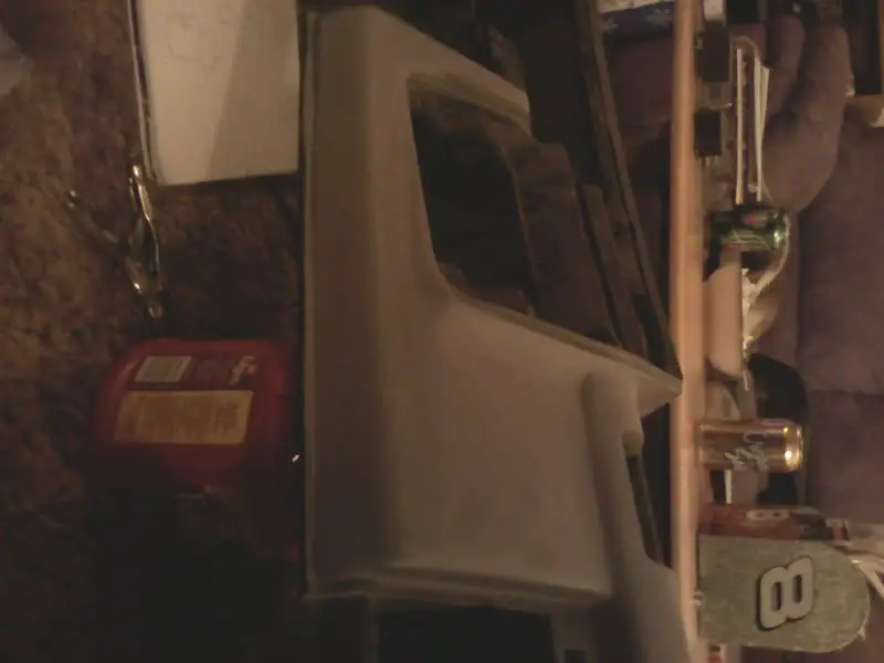

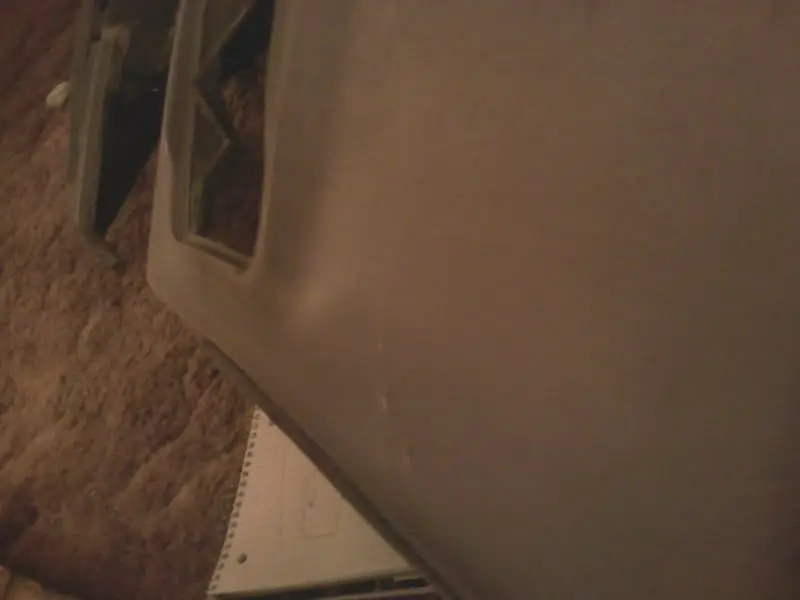

i got bored since i couldn't start my lift i decided to start smoothing out my spare dash, which turned out to be a later model of the 91-94 series that is more curved.
i'm hittin it with 120 to knock the bumps down, then i'm going to spray high build primer on it, follow that with 320, more high build primer, then finish it with a high grit paper(600-800).
then i am going to primer it again and do 2 coats of gloss black and 2-3 coats of clear.
crappy cell phone pics.
showin the low gloss after 120
dash thats almost fully sanded with 120
