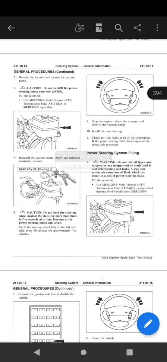

2003 explorer sport Trac. Put a reman O'Reilly's steering rack and pinion in , new xrf ball joints and tie rods, a new Edelmann steering pump and hose. Filled and vacuum bled with mercon v. Steering assist at idle isn't what it should be, feels like it's struggling to turn. 265/75r16 tires. Any ideas on what else to Check? I've bled it a ton.
