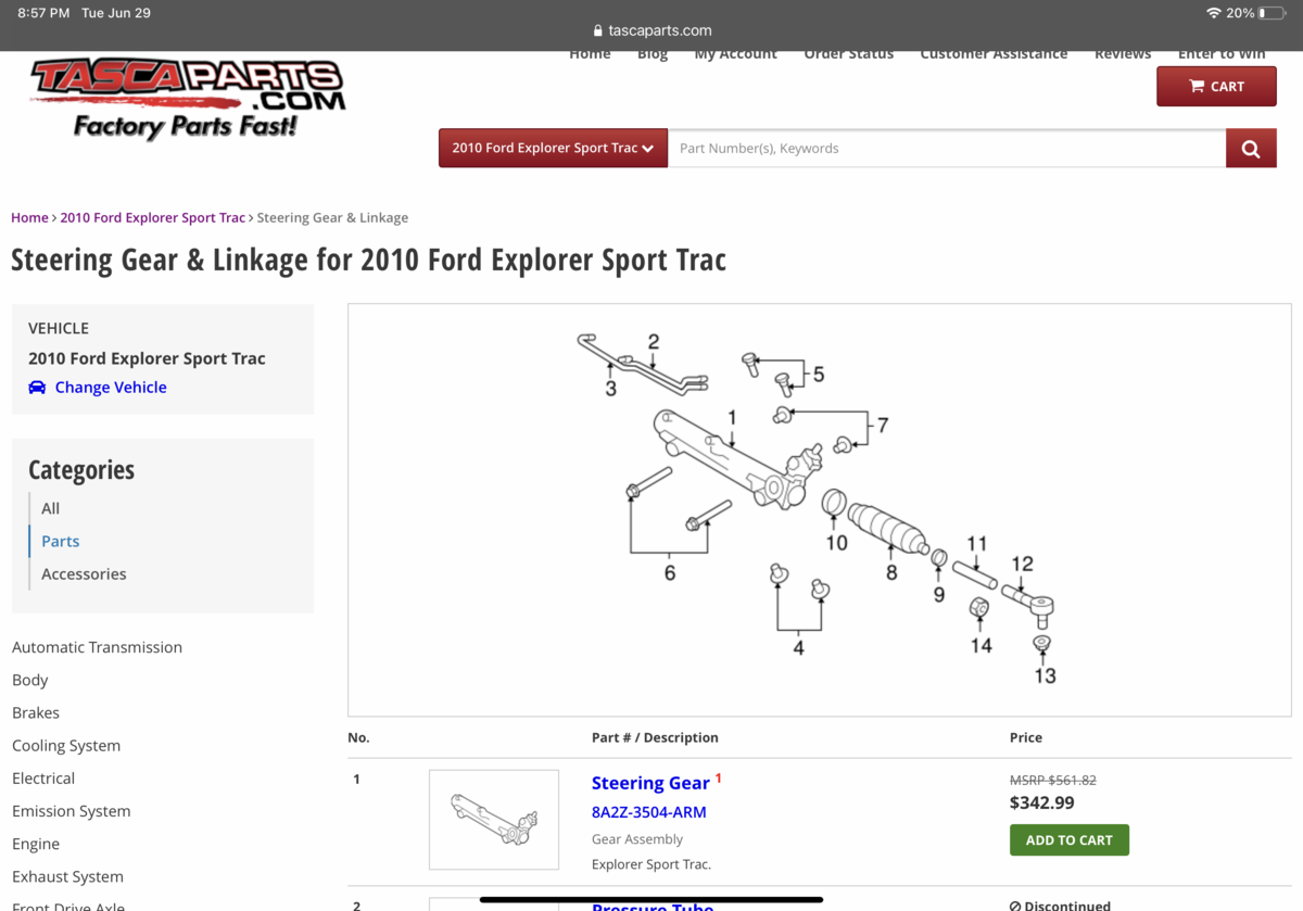

At my company we use around 200 a year Ford f150 racks in our 4 wheel conversion only Ford parts Tasca charges 10% over cost not 20 off of list, the guys are fast and easy to deal with. My 2 cents.
+ plus’s a 2 year over the counter warranty and they pay up to 150 labor even if you install
What's their 2nd gen Explorer price these days?
I was debating on a Ford rack about six or so years ago. They were only $180ish plus a core then, I liked that but didn't need one yet. I should have bought a couple, but I didn't have any cores to trade in at the time.
About three months later the price had changed, to over $400. Ford had changed suppliers and got rid of the prior inventory, and prices as usual popped.
