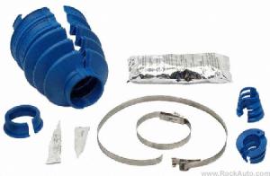

Rather than unbolt anything, I would prefer to just cut the old boot off and install a two piece repair kit similar to the kits used on constant velocity joints. The one shown below is by Raybestos (PN 8161037) and fits a lot of models including a 2000 Toyota Corolla.
The equivalent one by Dorman (PN 614632) has a large end ID expandable from 3.19" (81mm) to 3.76" (97mm); small end ID expandable from .8" (21mm) to 1.2" (31mm). My shaft measures .732 inches but the large end is only about 1.5 inch. However, if I can't find a boot repair kit with a better fit I could attach the big end to the outer lower section of the stock boot.
Has anyone tried something similar?

I was unable to find a Ford replacement part online. However, I found a General Motors boot kit that has possibilities:
There are two halves fastened at each end and the middle with clamps. It's used on 2007-2012 Escalade, Avalanche, Silverado, Suburban, Tahoe, Sierra, and Yukon. Does anyone own one of the above to measure for comparison? I'm tempted to purchase one ($35+S&H) just in case it might fit.
