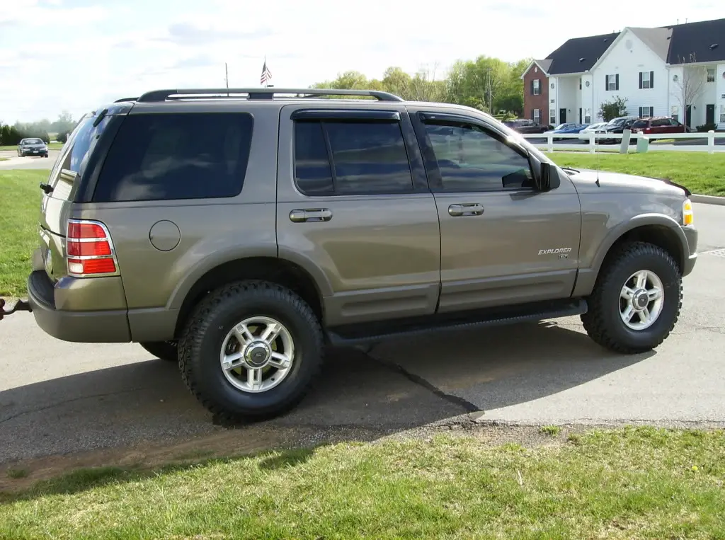

Body lift and tires before spacers
HA! Nice 5.0LTREDDIE. My truck is the same color. Are those 265/70 or 265/75 BFG's??? I still haven't decided on white letters in or out on mine...

Those tires are going to be mighty small with over 5" of total lift, you'll want to get larger ones pretty much as soon as you see the overall look ;)

5.0LTR.EDDIE, if i went with a 2" fr/2" r without a BL would 285's rub the control arms?
I believe the issue with 285's is the overall tire width. The tire may touch you upper control arm. You need wheel-spacers to run these tires, moving the tire outwards. I believe the largest you can push is 265/75/R16's (roughly 32's).
Also important, how willing are you to start trimming???
I did use spacers to fit 285/75/16 and as soon as I get my spacers i will put detailed pics out there. The bad news is I screwed up my zip code when i texted him and now i have to wait till they surface and have them aired to me. I apologize and thanks Brandon for the great communication.
i really dont want to start trimming the inside of the wheel wells so im just gunna stick with the 265's
You can run 285/75's without wheel spacers....you just need to have an aftermarket wheel with the correct offset.
