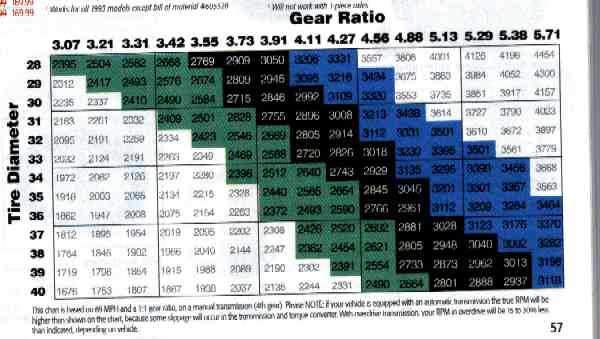

The big deal with stock 3.73s and 33s is the engine RPM at cruse.
You will basically loose your overdrive for anything less than 70 MPH or so.
Here is a chart to help you figure out your gearing. Check the RPM range for the tire size and gearing you want to run. The closer you keep it to stock, the more you will like it unless you are looking for a performance advantage, then go one step up in the RPM band. For instance, 4.10s with 33s is close to stock, 4.56s will give a performance boost and still work great. I recommend the 4.56 for 33s, but I'm running the 4.10s myself and it is OK.

thanks for the help. i was thinking about running 4.10s also but i'm not sure. I'm gonna worry about getting the lift and the tires/wheels first. then just drive it till i got the money and time to get the new gears. I work at a repair shop so I got all the tools and only have to pay for parts.
