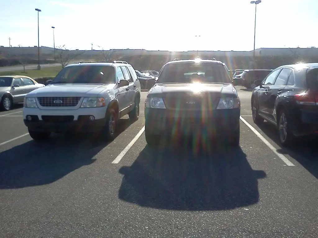

So my guess was right about the front bumper covers swappable? Looks super easy to do. Can knock that out even in this weather. Got the tow hooks last week. I just need to know if I have to look for some brackets or extra bolts while I wait to install all this.

I ended up meeting the lady who owns that one. She let me look at the patterns...direct match!!
