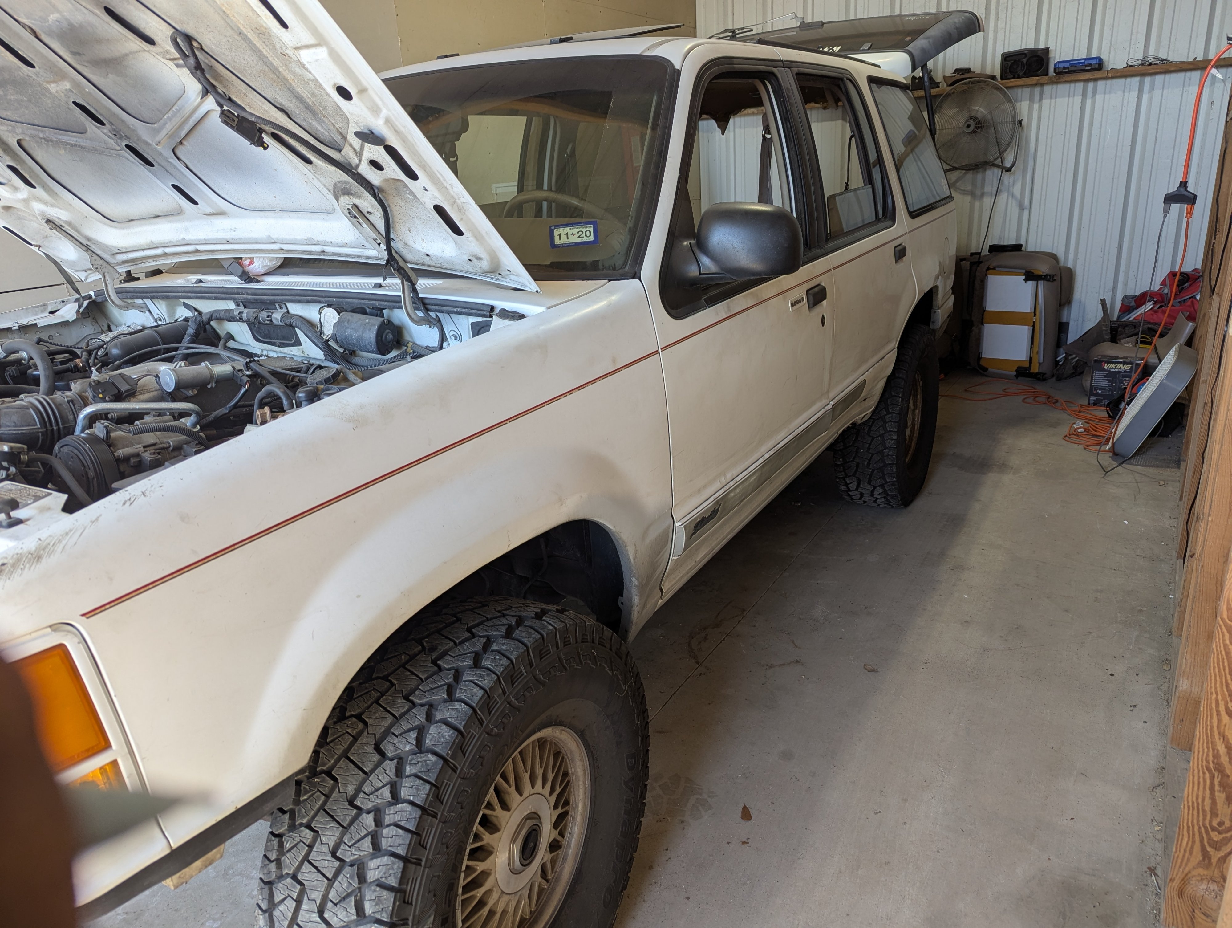

Spent some time over the past couple of weekends giving Stripe some attention.
Well not the attention he needs, like steering components and pinion seals, but something actually important... like a 1" body lift I made 6 years ago. 😁
I stripped the interior out over a year ago in an attempt to clean it and then I wound up adding another car to the fleet which necessitated Stripe's move to an undisclosed location in an unfinished state.
Roll forward 15 months and here I am. I got the itch to get back out on the road with Stripe so I am making a concerted effort to make him roadworthy again, so of course I started with a body lift.

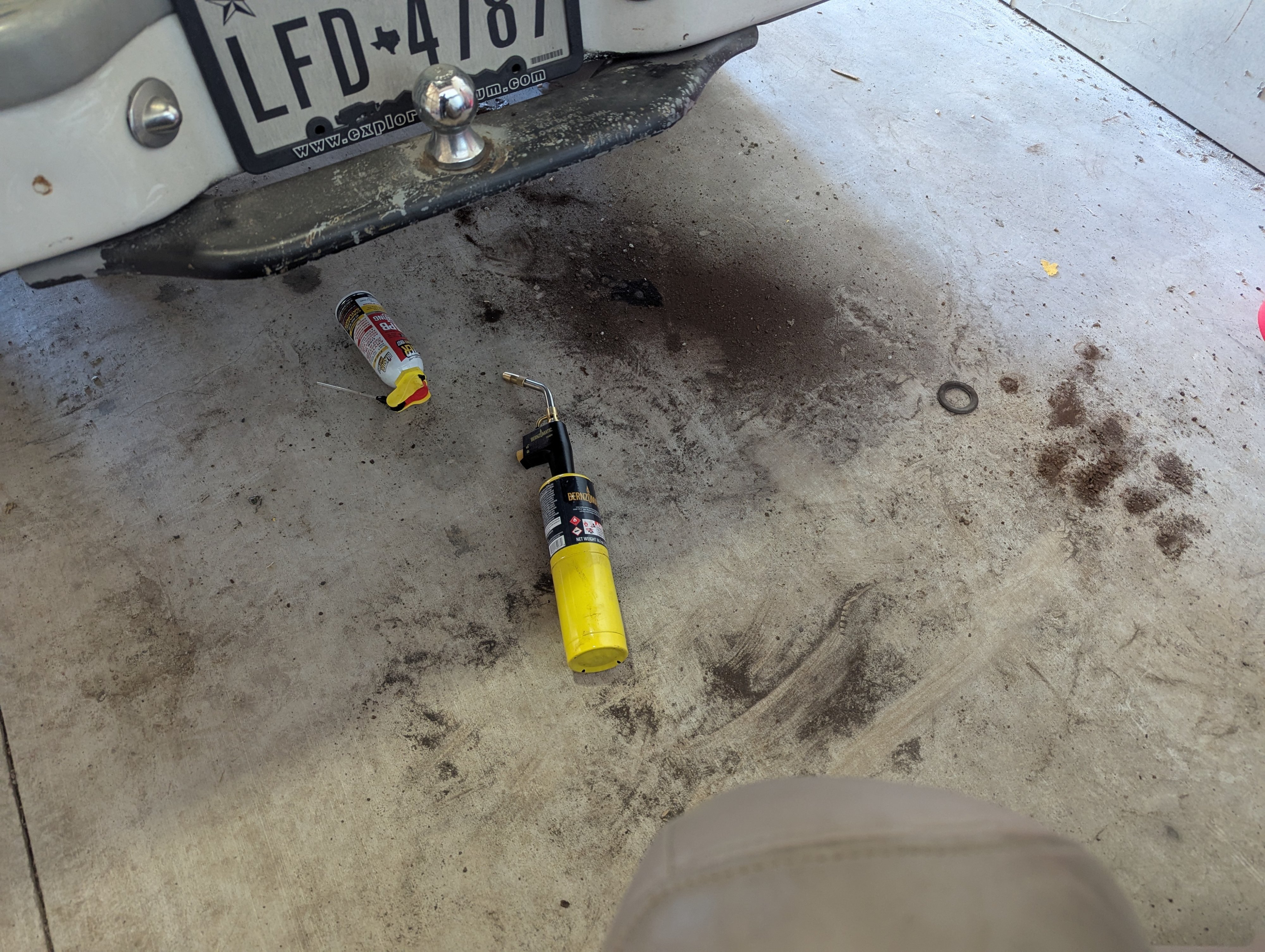

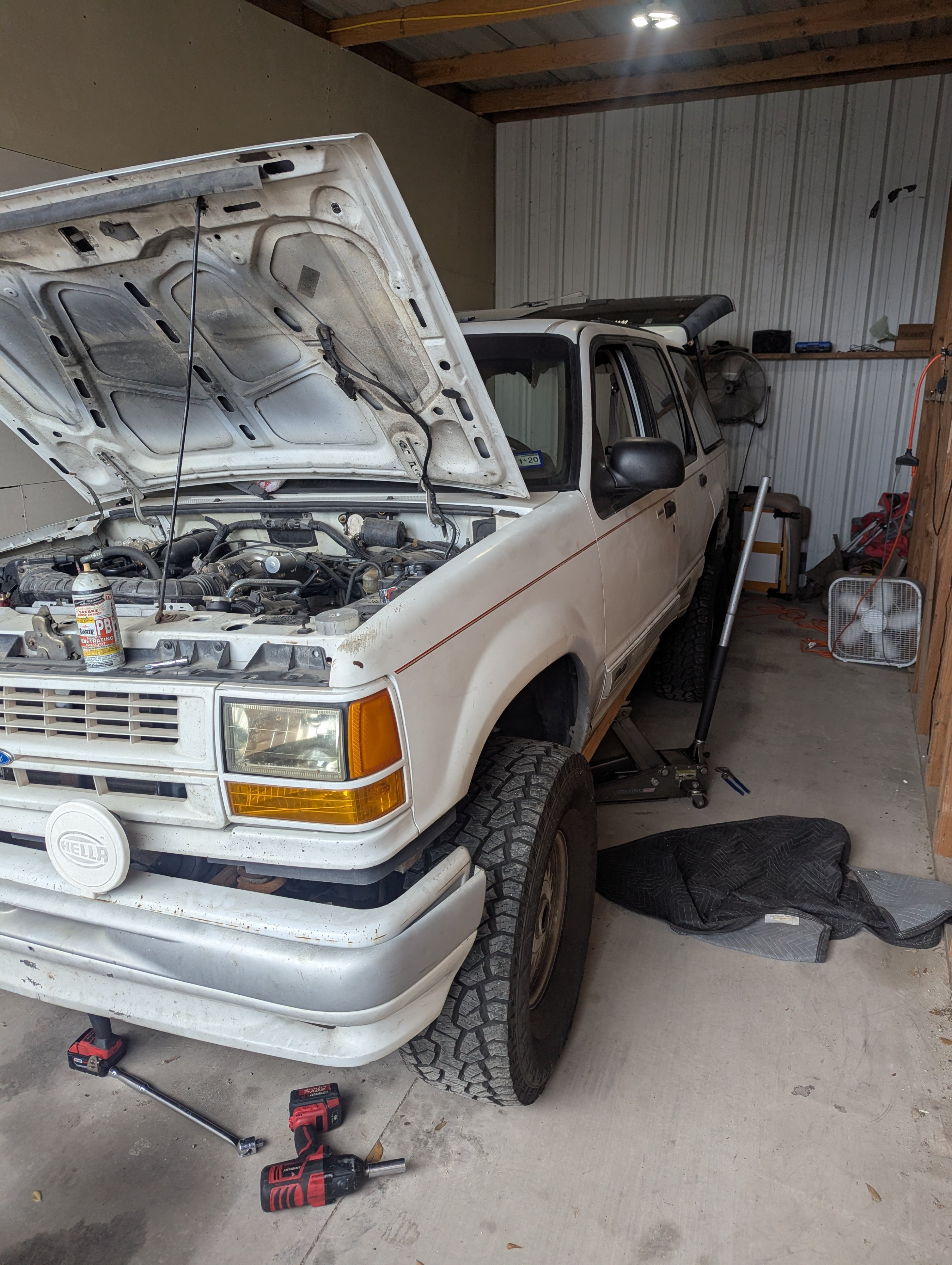

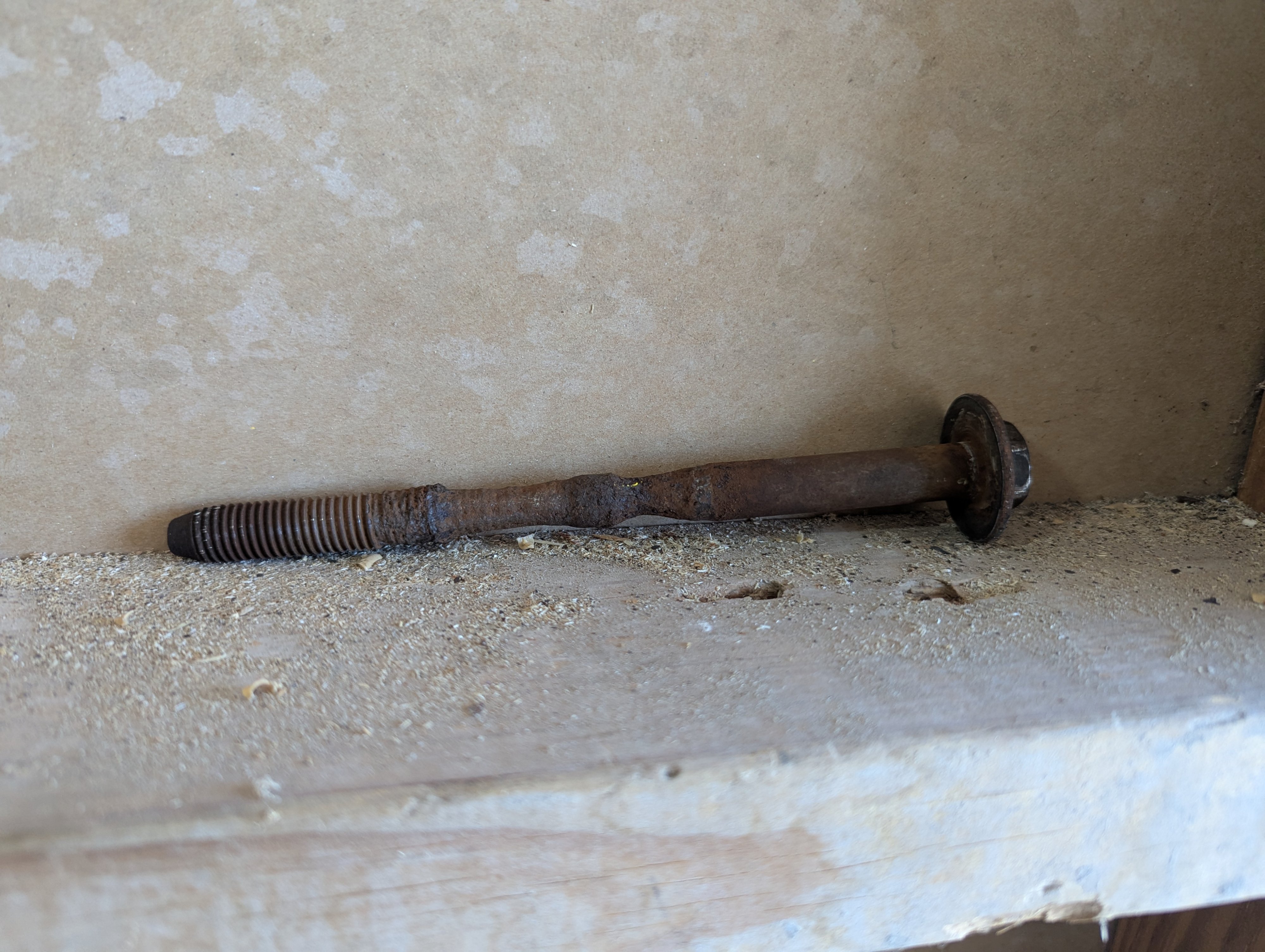

Last Saturday I started in earnest to get the body mount bolts out and with Stripe being a native Oklahoman truck, salt had done a number to these mounts, making each one another layer of proverbial hell.
If the mounts weren't spinning, they were stuck, and if they weren't stuck, they disentigrated. Lovely. So I threw my hands in the air last weekend after only getting about 40% of the spacers in.
The front mount was spinning and the bolt and nut were rusted together. After every epithet in the book escaped my lips, I packed up in the Maverick and formulated a plan to get 'er done next weekend.

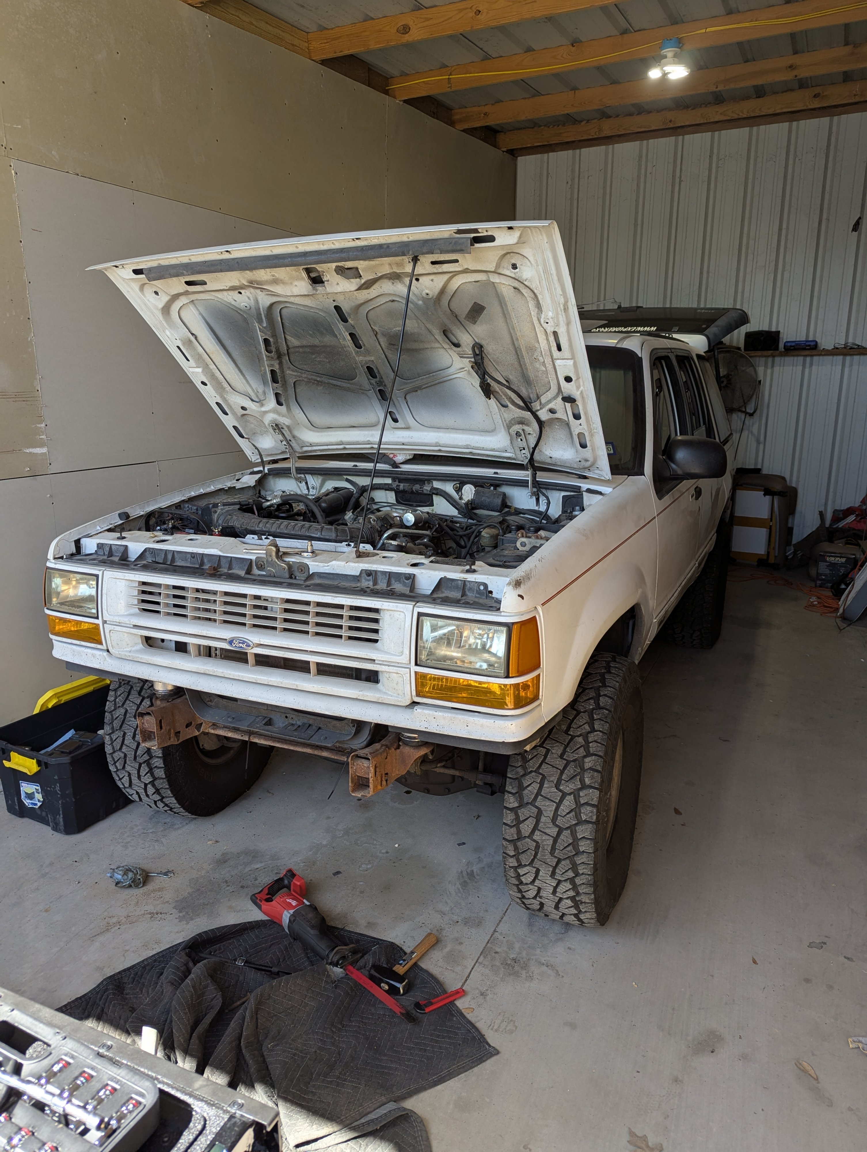

So my plan this weekend was simply, "no more mr. Nice Guy" and broke out the torch, some big ass wrenches and the sawzall. After some ”gentle" persuasion, the body mount bolts saw the logic in my reasoning and came loose, in pieces, but loose.

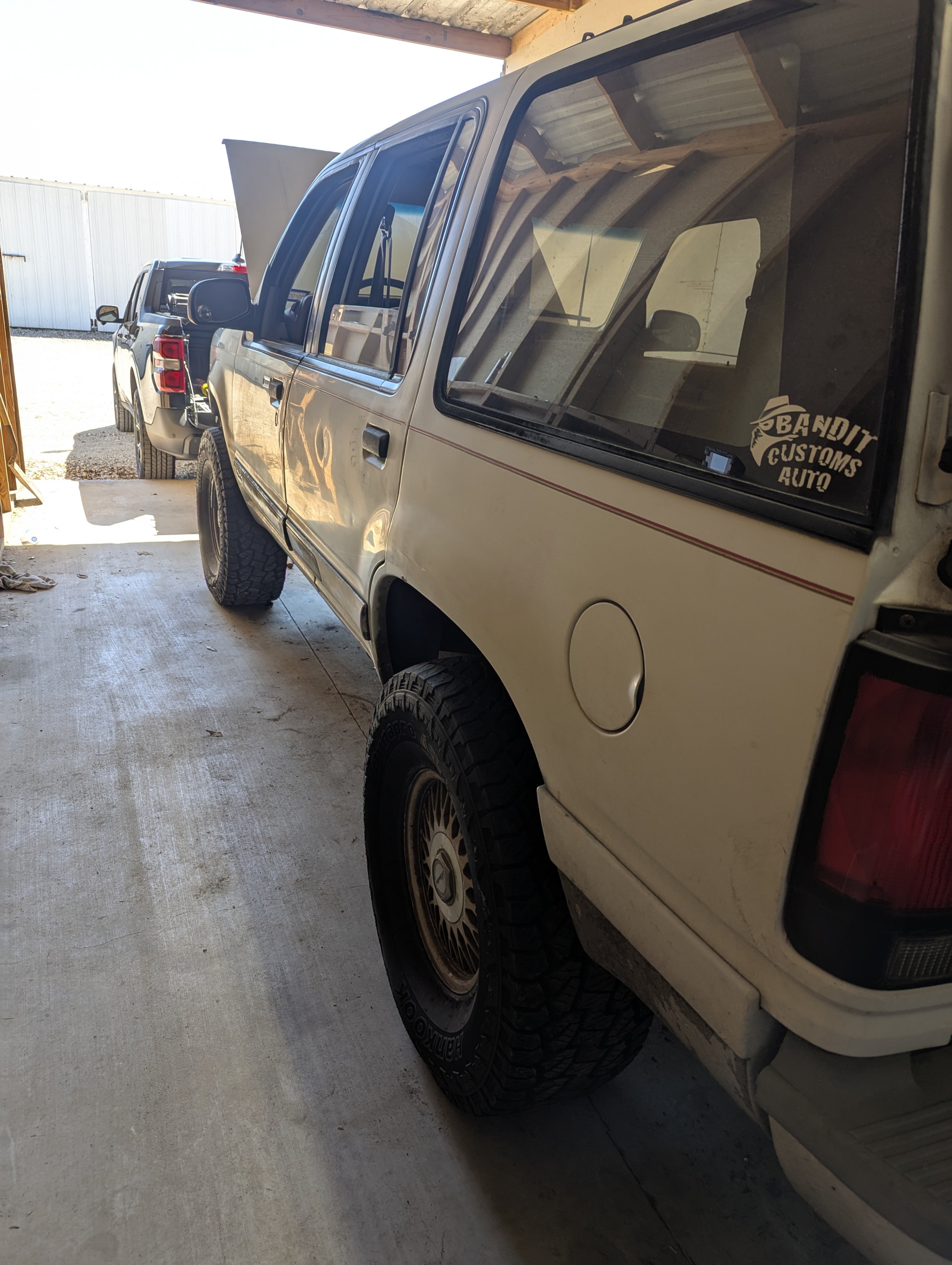

With clear sailing (and fishing a bottom bushing back in place on top of the gas tank) Stripe's body lift is complete. I wound up using some zip ties to drop the fan shroud and other than the routing the e-brake cable, everything works.
There is still a lot of work to do, mostly interior and steering components, but for right now,I am just so dang pleased the mounts I made worked and they Stripe looks great with that extra inch!😁👍

Wow those bolts have lost some weight!
