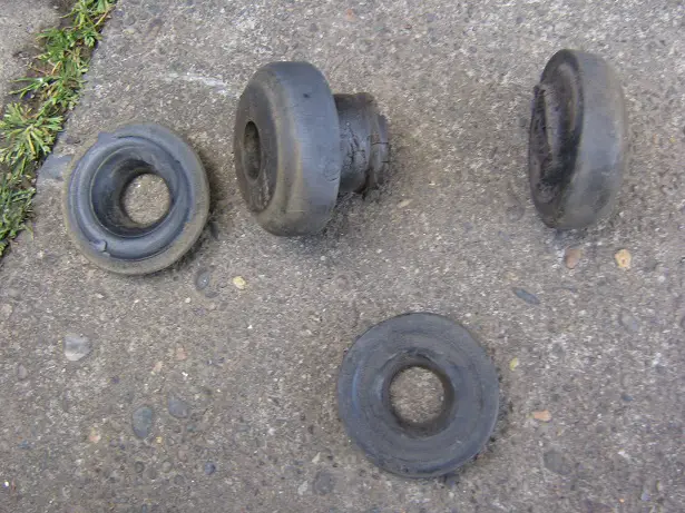

Changed out my Radius arm bushings today. A job well worth the time, almost all clunking noises gone. I will post some pics of the tore up bushings tommaro.

Got Radius Arm bushings?
As you can see I was in desperate need to replace my radius arm bushings. I would hear a awful ckunking noise. My girlfriend was always spooked by these noises thinking the tire would fall off at anytime. After I installed the coil spring spacers the noise went from a clunk to a twang as the noise would recoil through the aluminum spacer and into the spring. So I did the research wich I have several times before and decided enough is enough. Even though it was raining outside I went ahead and did it anyways. I picked up a 11.99$ RA bushing kit, but wanted the energy suspension kit. It was a little dit of a pain in the a$$ but all was well. The onlt recomendation is buy 1 3/4 in x7/16 dia bolt because the 1 1/4 in reccomended will interfere with the fuel filter holder. Well got past that issue and now that all the rivits were grinded and bolts were in place it will be easy to swap out the cheap bushings for Energy suspension bushings later.
All said and done I am well satisfied and no more clunking over speed bumps, pot holes, in and out of driveways ect. A job well worth the work and the front end feels tighter and handles better.
Here are the pics
