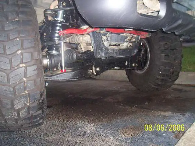

I thought it was the upper ball joint all the time too but is not the case with the RCD. What limits me now is the coilover. I have about 4" of droop from ride height.
It only includes front brake lines. I am still using my stocker in the rear, I just had to bend the bracket down.
Also look at the angle the upper arm is at, I dont think I will have too much premature wear like with cranked up t-bars.
What about the upper arm isn't it the CV you need to look at?
I haven't had a need to upgrade the rear but there is a site online that will do the rear for around 60$ (Steel braided and extended)
The CV also wears but as much as I have seen t-bars cranked up I havent seen problems with CVs
