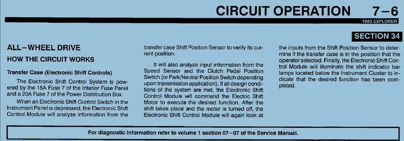

If its E-shift... There is a red/white wire at the trans that needs to be grounded when the trans is in neutral.
It goes to the electronic shift control module
