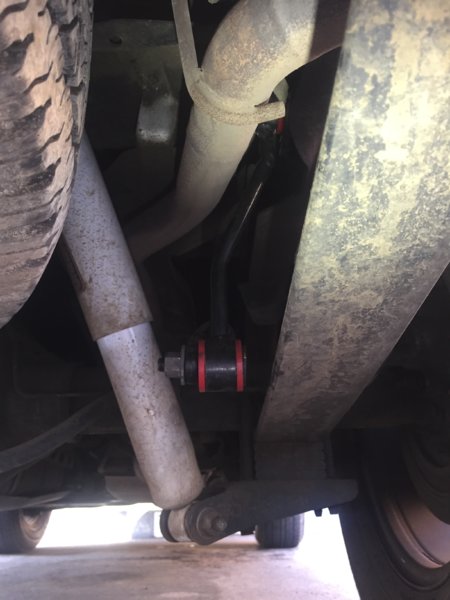

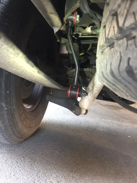

I did the rear sway bar end links on Saturday. Since I was just changing the bushings with a prothane poly kit, the challenge was to remove the old bushings keeping the OE hardware intact. Found quite a clever way described in this video using a gear puller -without burning them-:

Well, the original ones were shot, so putting a piece of cardboard will be better than keeping them.
The new ones were really easy to install. The kit comes with 2 half for each bushing. It's like playing with Lego. The difficult part was extracting the old bushings with the gear puller, but it worked ok.
Driving now seems more stable, can't feel a difference in stiffness, I do have way less vibration and road sound in the cabin. Still need to test it in bumpy and dirty roads, since the truck had problems keeping the tail straight in those situations with the old bushing kit.
^ That could also be the leaf spring bushings and your axle dampener (shock), and a bit of the nature of these vehicles, especially with a shorter wheelbase Sport... or did the Sports omit the axle dampener??
