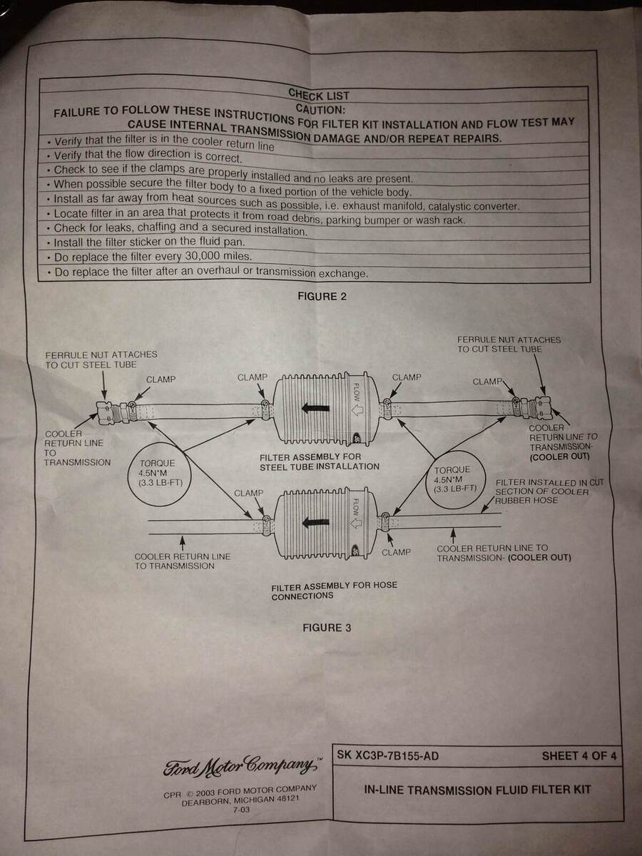

Thanks, but I went ahead and bought 12 quarts of the Redline D4 ATF and only paid $85 for it. I also have an inline Motorcraft filter (XC3P7B155BC) that I'm going to install, I just need to figure out if I it's the pressure side or the low pressure side I should install it on. Any Ideas?
Dug out one of my old Ford filters from the garage. Hope this helps!

If you are installing an external filter in the trans lines, place it in the output line if everything is working great. That will protect the coolers from contamination from any future failure, and they don't need to be replaced at that time. If there may be any debris in ATF or coolers now, or has been before, place the filter in the input line to the trans. That will protect the transmission from any contamination from the coolers now etc.
