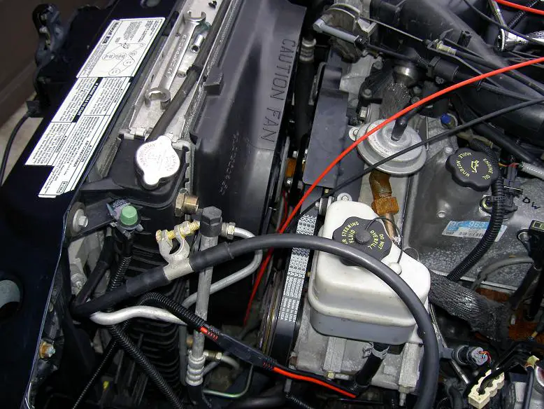

There are four O2 sensors, over $75 each at Ford. Unless the mileage is high(125k+), I'd not suspect those yet. The upper intake gaskets are evidently very prone to leaking, they cost less than $10 for the upper set. Buy those from Ford and spend an hour or two to carefully change them.
The EGR is on the front driver's side of the engine(in front of oil fill cap), it and an exhaust leak should not create a full lean code set. I think you should be looking for an upper engine vacuum leak. Good luck,
