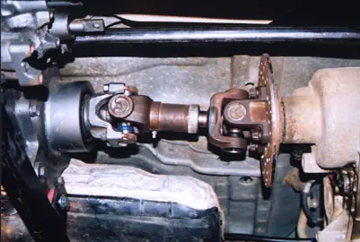

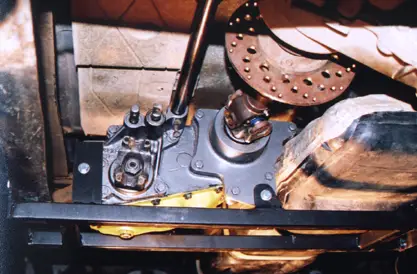

THE EXISTING MOUNTING HOLES IN THE DISC HAD TO BE WELDED IN AND NEW HOLES DRILLED TO FIT THE STOCK FORD FLANGE. (TOYOTA'S HAVE A ROUND PATTERN, BUT FORD'S IS RECTANGULAR) MAKE SURE THE DISC IS CENTERED PROPERLY, OR SEVERE VIBRATIONS CAN OCCUR. THE PICTURES SHOW HOW THE BRAKE DISC IS MOUNTED BEHIND THE FLANGE ON THE EXISTING BW-1354 T-CASE.
[/URL]
[/URL]

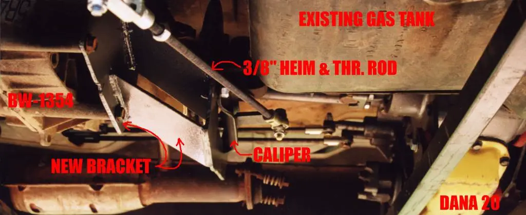

THE CALIPER MOUNTING BRACKET IS MOUNTED TO THE REAR OF THE BW-1354 USING THE EXISTING FOUR BOLT HOLES ON THE REAR OF THE T-CASE. SOME RANGERS / EXPLORERS HAVE A COVER OVER THIS AREA, WHICH IS NOT NESSECARY. (sorry, not the best picture)
[/URL]

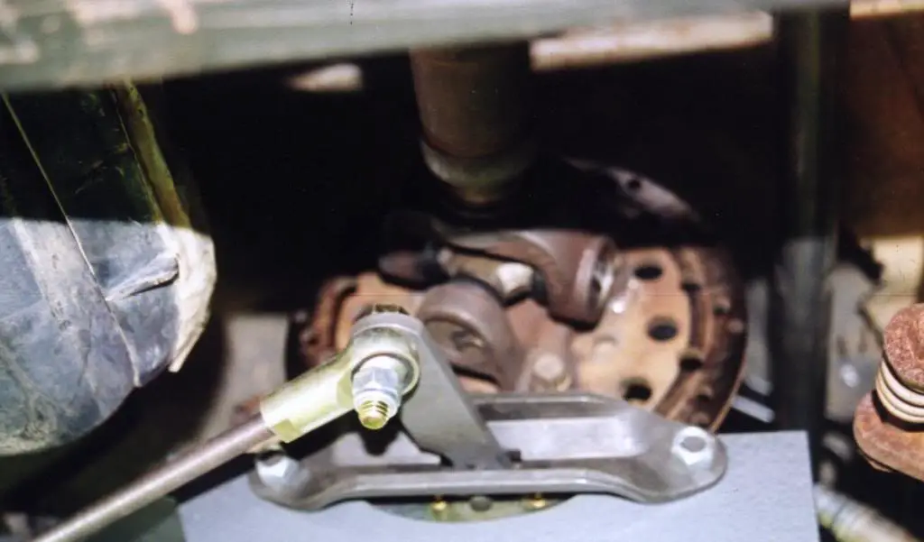

THE LINKAGE USES 3/8" THREADED ROD, WITH 3/8" HEIM JOINTS ON EACH END. THE EXISTING E-BRAKE CABLE WAS SHORTENED AND TIED INTO A PIVOT, WHICH ONE END OF THE ROD/HEIM IS ATTACHED.
[/URL]
(sorry, no picture of pivot bracket)
WHEN THE FOOT PEDAL IS PRESSED, AND CABLE PULLS ON THE PIVOT, WHICH TURNS AND PULLS THE LICKAGE THAT IS ATTACHED TO THE CALIPER, TO SET THE BRAKE.
THIS SETUP HAS A MUCH STRONGER HOLD THAN A STANDARD REAR AXLE DRUM E-BRAKE.
