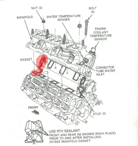

Did you test the resistance of the old one before removing it? Test the new one. You mentioned that the plug could be bad. I don't know if they sell a replacement in the auto parts store, but you could check. Send KBabiak a PM. He should have the correct plug. Most of the time the single wire sending unit is used unless you have a digital temperature gauge. Then this 2 prong sender would be used. Most wiring harnesses have both plugs. Did your old one have 2 wires like this one? If you are not getting a signal, then most likely the wrong plug was used. Look for the single wire plug, and ground it. Your gauge should jump. Here is a troubleshooting chart for the two wire sensor:
And an OHV pic
