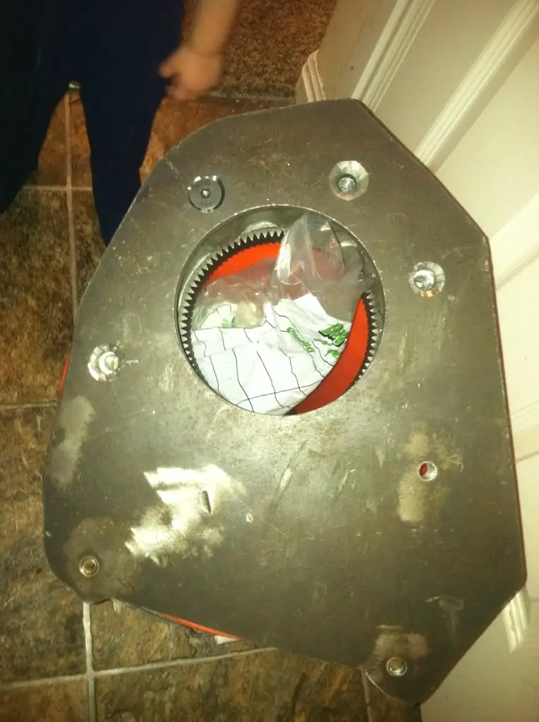

Ive been making gaskets for a long time, started when I was 14 working on dirt bikes lol. that's what I should have done, but I got myself in a big damn hurry. I'm going to take the remainder of the 1/2" plate I have over to the shop tomorrow and see how hard it will be to just make a new plate, with the holes drilled in all the right places, and hang the other one on the wall as a reminder to slow the hell down. live and learn I guess, but yeah Rick your right that's exactly what I should have done.

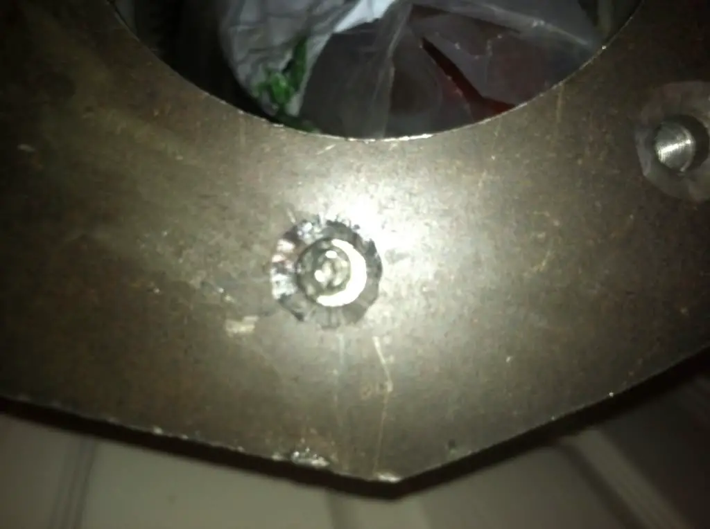

got a little crazy with the die grinder and made my own countersinks lol, once I had them roughed in I put the bit I bought in there and smoothed them out, ill post pics tonight but that part is done

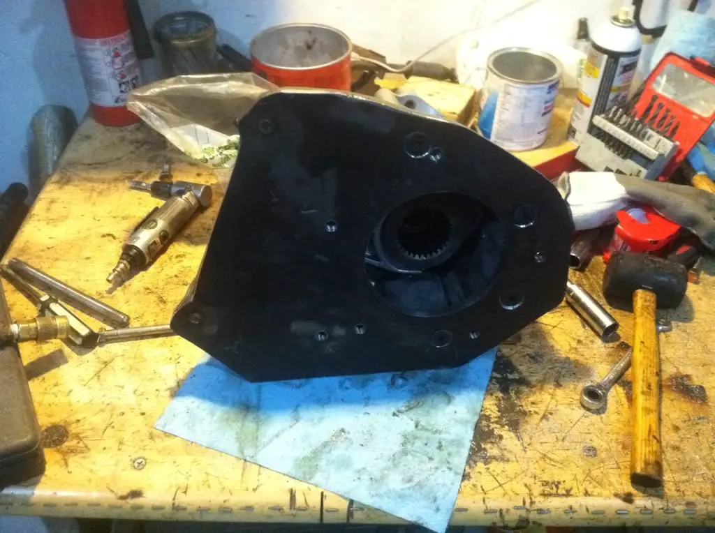

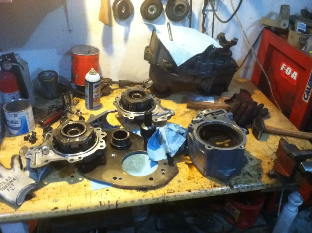

ok so I got the countersinks done on all 4 bolts, you can see that 3 are off center of the hole but they are all countersunk straight in relation to the holes. I took the planetary set off of the main transfer case and marked the holes for it, they are all in the right place thank god. So I just need to drill and tap them and its time to clearance the case for 2 of the bolts that mount the planetary set to the plate. then final assembly.
also went to the steel place and got 20' of 2x4" rectangle tube with 3/16" wall thickness and their last 3 sticks of 1 3/4" .120 wall tube, have to buy 2 more sticks when they get some in, probably get a stick of 1 1/2" for braces and stuff too. after the doubler is in I can start the body modification, the bottom of the body should be about 2" below the bottom body line.

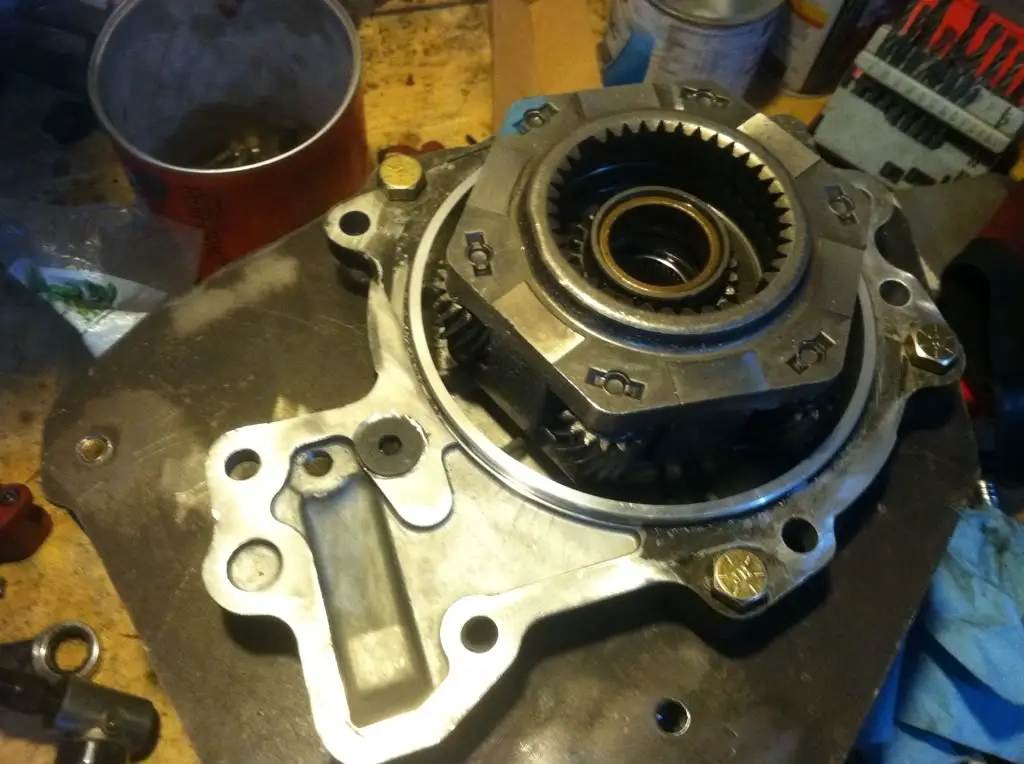

getting closer and closer, ended up making the bolts holding the planetary for the tcase 7/16" instead of the 3/8" that the trs guys did, mainly bk I screwed up the first ones and wanted the others to match. Just got to go get bolts and I can start the mockup assembly, just make sure everything goes together before final assembly and install.

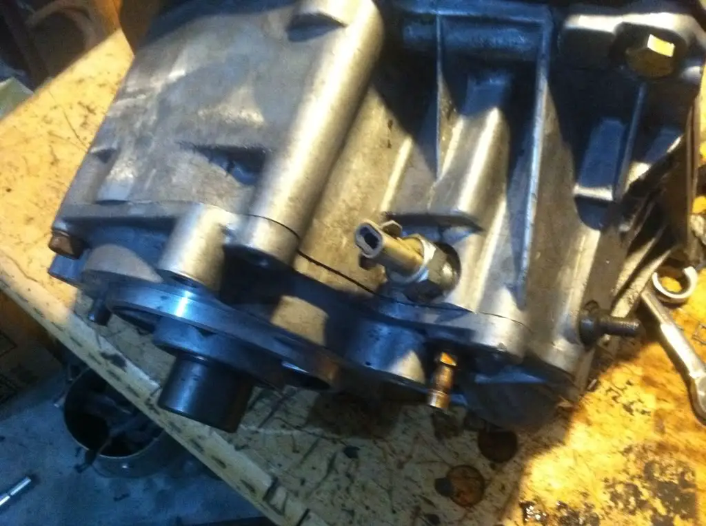

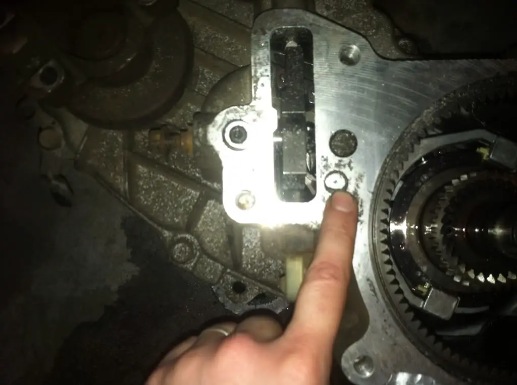

went and got bolts, I realized that the 5th bolt would be inside the case, and it has no room for it in between the planetary and the main case, so I ground out a countersink and picked up a allen head bolt that would sit flush with the planetary case, here are some pics, im getting pretty damn good at countersinking bolts with a die grinder haha.
you can see the counter sunk black bolt no the side there

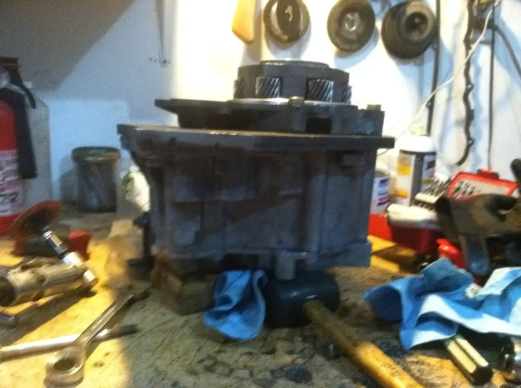

and here is where the bolt head would hit on the main case

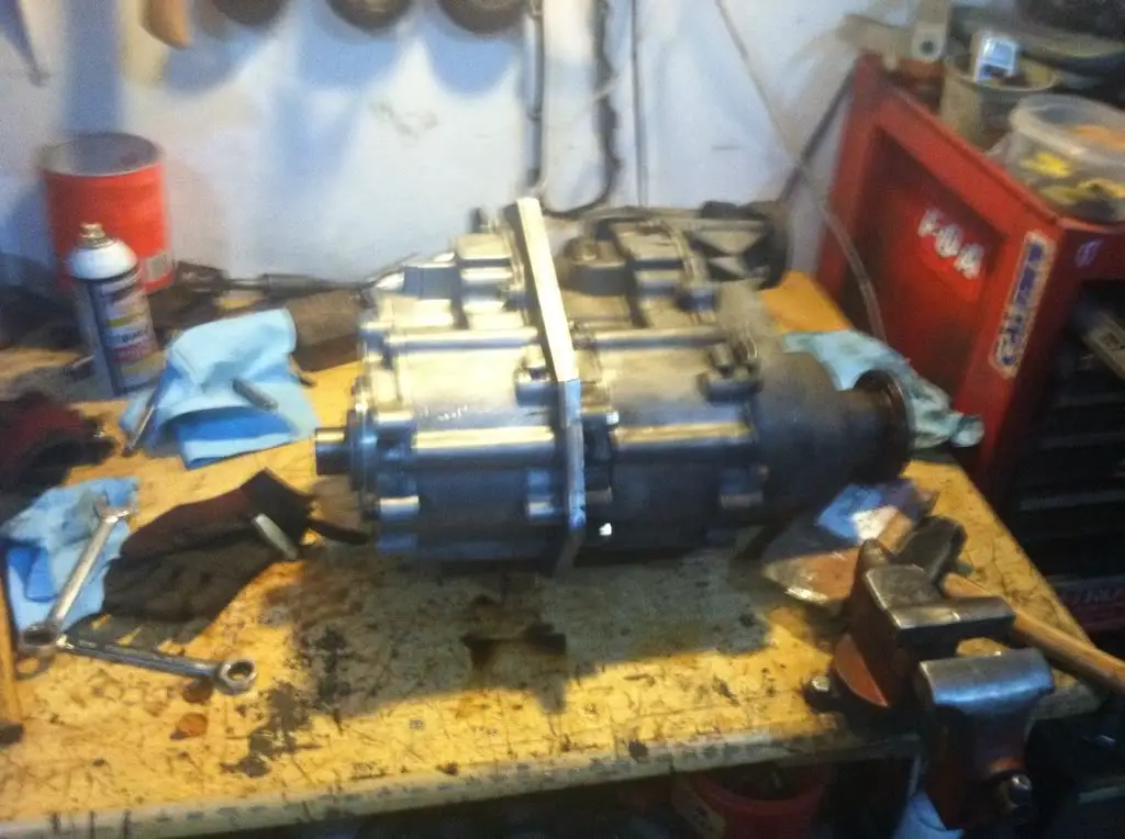

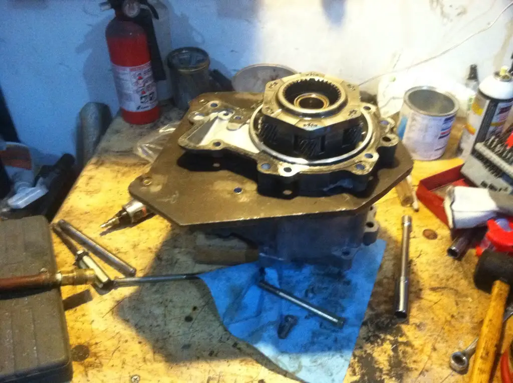

here it is all bolted together;

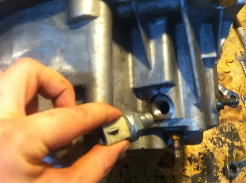

who thinks the unused shift indicator would be a good fill location for the doubler case? I already know it takes about a quart of fluid.
Seems perfect to me. Or just pull off the vent tube off of that vent fitting and use one of those pump type gizmos.
yeah im sure thats how its going to go down, maybe ill get a plug in place of the sensor, of course it makes a plug thats just fine, and its free. getting closer and closer to 6.25:1 reduction, its gonna be awesome. Rick what was your atlas? 3.8:1?
