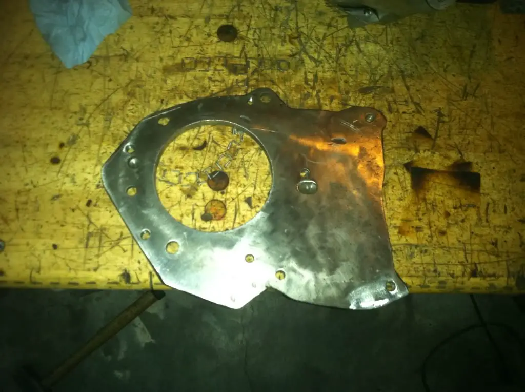

I finally got the doubler into the rig, (with some persuasion from mr 3 and mr 8lb sledge), I marked the plate for the bottom of the frame rails, looks like its not quite going to be a flat bottom like I was hoping, it sticks down about 2", but thats ok I have some 3/16" plate avail to me that ill make a skidplate out of to protect my cases, probably extend it up under the trans as well. im making the crossmembers out of 1/4" plate.

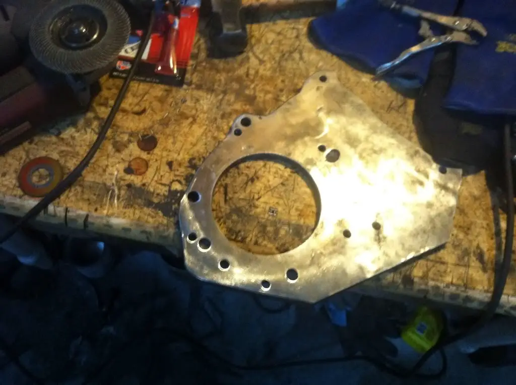

I also did the final cutting and grinding of the doubler plate itself, I left a spot for my cross member to bolt up, I plan on welding a tab to the tube for the poly bushing that bolts to the 2 holes ill drill in the plate, then the cross member will have 2 tabs to bolt the busing to, then the cross member bolts to the frame rails.
FWIW Just make sure there is some kind of play in the transfer case mount.
I contacted AA about securing the Atlas and they said "Do not attach anything to the case". Worried about the case fracturing.
I'm still thinking of some kind of poly bushing (wide to displace energy) that is mounted on both sides of the Atlas, but with no bolts. Have the bushings mounted on steel supports that are attached to frame and pushed directly against the case. Both sides cause of reverse.
yeah I don't want to attach anything to the aluminum case itself, but by attaching it to the doubler plate I think I'm going to be ok, should hold the tcase from moving under torque load pretty effectively. I've seen people attach cmembers to the back of the case where that weight thing mounts, but I thought I saw something where it had broken the back of the case out. I can't just rely on the stock cmember, that thing was twisting in low just with the regular tcase and the 4.0, hopefully I can rein all that in. Here is a pic of the finished plate, just need to drill 2 holes and paint it,

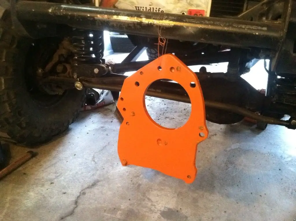

drilled the holes for the mount and painted the plate today, here is a pic,
yes it is very orange haha, its the colore Eric had laying around, wonder why...
