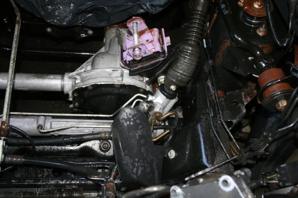

here is a picture when the engine was out I took advantage to clean the bay

Can you guys tell me what that hose connected to the front carrier is for? Thanks ... Mark in KC
That would be the vent tube
