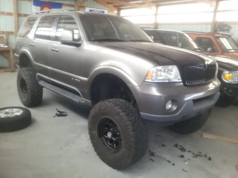

Look what Josh did to his wife's ride-
http://www.explorerforum.com/forums/showthread.php?t=365704&highlight=aviator+sas
Turdle this looks awsome! He just did tires or also add a lift on her? Please ask him what he did, does he needs to regear it to compensate for those big tires?
Front and rear SAS. Check out the link under the pic Turdle posted for info on the build.
Ruins the look IMHO... Worng body style to pull that off...
Thanks Ronin, I saw all the hard work Josh did to her and it is really amazing his job.
