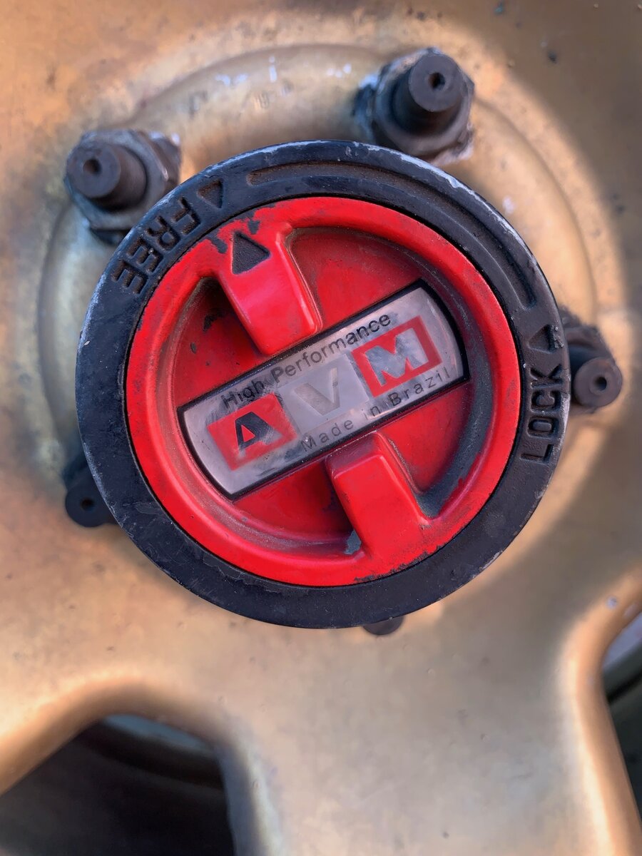

I noticed that on my '91 4wd, with one-inch spacers installed on the hubs before the wheels, the thumb knob doesn't stick out past the center cap. Apparently, I picked up some 2WD center caps. The 4WD caps were missing.
@410Fortune I suppose that my '91 4WD hubs are factory? Neither me nor the PO installed them..
