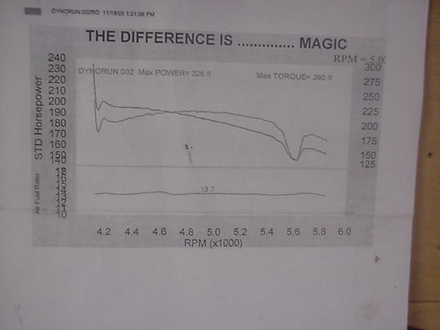

And this is what the SOHC V6 is capable of doing N/A,RWHP and TQ

Not bad at all. Hey Spindle, is that with all the bolt-ons available for the V6 or is there still room to grow left before having to go with bigger mods?
Just curious and in no way trying to flame, but why aren't your torque and horsepower curves crossing at 5,250 rpms?

Someone got all in depth about this in another thread, but it's due to the type of dyno they use.

It cannot be the type of dyno they use because the dyno only measures one thing and then uses an equation to figure the other. If a dyno graph does not cross at 5250 rpms then something it out of whack and the numbers cannot be trusted. I am not saying Spindle's truck isn't capable of making those numbers, because I bet it can, but that dyno graph is messed up.
The equation is as follows:
RPM x torque/ 5252 = HP
Their math was off or something when their software graphed that line. Another giveaway that the dyno facilities math was botched is that the torque and horsepower lines or only supposed to cross once. They cross twice in that graph. Spindle I don't know who you went to to get your dyno done, but they screwed something up. Its cool though, **** happens.

What correction was used? Its not indicated.
It is not even about the correction, it is about the actual torque converting to horsepower formula that was off. Not the correction of SAE, STD, or RAW.
I know why the lines aren't corresponding! The damn idiots used the type of graph that plots the left side with horsepower numbers and the right with torque! That is an old way to graph the numbers, and is exactly why the sheet doesn't appear to be correct. I still wonder why the dyno sheet started at 4,000 or so RPMs and had such a high spike there. Unless it was where the truck shifted to 4th gear at? Man that sucks, as tuners they should have temporarily locked Spindle's 4th gear so that he could dyno with 4th without the tranny downshifting to 3rd once he floored it in 4th. It sure is fun figuring out why dyno sheets go the way they do! Either way that graphing method is the prime example why most tuners have switched to the method that plots torque and rpm on the same graph with matching index numbers on both sides for both measurements. It leads to less confusion.
Spindle's actual numbers, not counting the torque flare that most likely happened during the tranny shift, are around 220 rwhp and 190 rwtq. I would get more accurate but the picture of the sheet was from too far away so I couldn't line the numbers and lines up too precisely. Still not too bad for a V6!

Correction for what Al.
This was not my trac, is a friend of mine.
Rockets correct I believe, all my graphs cross at 5250.
My trac and his are set up identicle with the exception that his has a stall convertor, he runs 30lb injectors (which most likly do's nothing for him)
He do's his own tuning with the SCT flasher, and he runs 103 octane gas.
As you can see it was done on a Dynojet, they correct for altitude, temp and humidity.
Rocket, being done as you posted above, do you think the final numbers are correct?

Not the ones stated at the top of the page of the dyno sheet itself. The only reason is because it looks like they only showed the sheet from when they revved it when in 4th and dropped to 3rd and then right after the shift back to 4th again while WOT is when they started to record. But their recording already started before the shift was complete, thus you see a power flare from the next gear engaging. The graph after that shift flare is most likely pretty accurate, but the computer software looks at the total of all that is included in the graph, which did include the flare at the beginning.
Some places lock the 4th gear out and others don't. That is why Troll's video of his Explorer on the dyno showed his truck bucking when going into 4th gear. If his tuner had the graph turned on at that time then he would have seen a power spike too. Some tuners lock the autos out, and others just run it through and only record when it had finally hit 4th gear while WOT. The same power spike can also happen when the TC locks into 1:1 too.

What dyno facility did you use for the testing?
