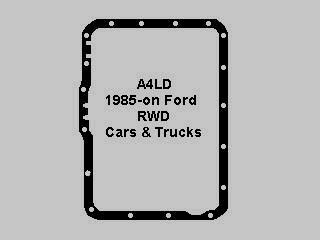

for the A4LD there are a few quick ways to tell if you have the right one, first step is the trans pan, here is a picture of gasket
this site has a lot of good info about the transmissions, and other trans's your likley to find around the explorers in the junk yard
http://www.therangerstation.com/tech_library/AutoTrans.html
If i remember right the ID tag on the rear right side will say A4LD on it.
