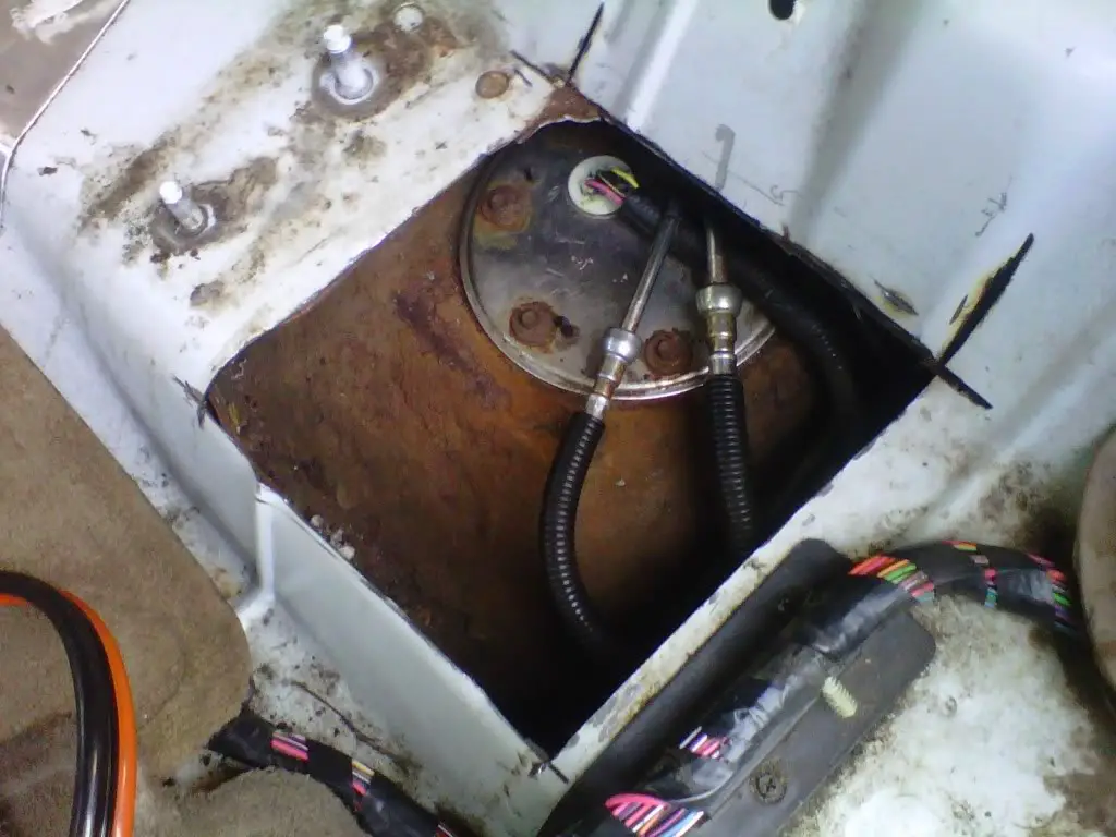

Lets start off with my current issue.I have determined that my fuel pump is shot. The truck is stuck in my driveway so I had no way to lift it up high enough to drop the tank so I went ahead and did the floorboard cutout trick to gain access to the top of the gas tank and fuel pump.

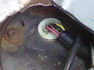

I have the tool required to remove the two fuel lines - no problem with that however I am not sure how to remove the electrical connection that is attached to the top of the fuel pump cover plate. I looked in the Haynes manual and their pics show what appears to be a socket like connection but my connection looks almost like it is one piece (not a male/female connection). I tried to pull the connection apart (gently) by grabbing the four wires and pulling/wiggling upware and it did not seem to budge. I then tried using a needle nose to grab the base of the connector pulling upward but again it did not want to move. Unless I am mistaken I think that the connection may not be a male/female type - - unless I am just not pulling hard enough. I don't want to pull too hard and break anything.
I took several pictures that will show what I am talking about. When I tried to insert them into this message I am being asked for a URL. How do I do this? Any free places out there on the net where I can upload and link to ?
