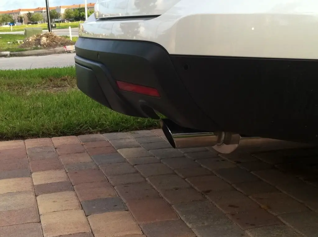

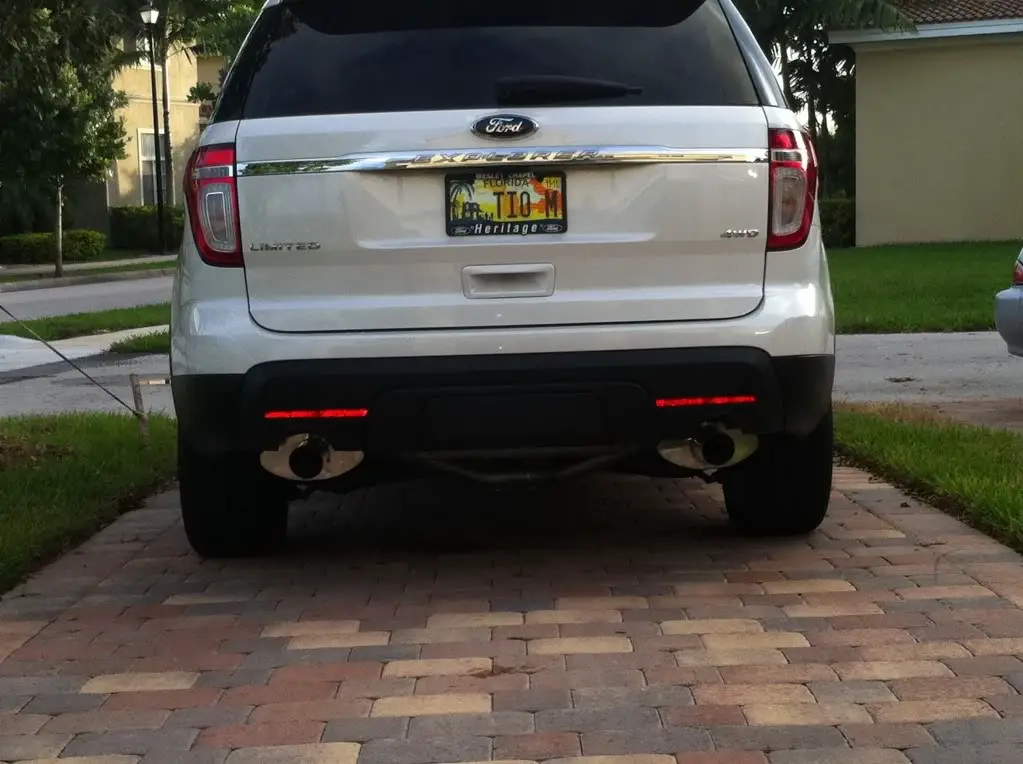

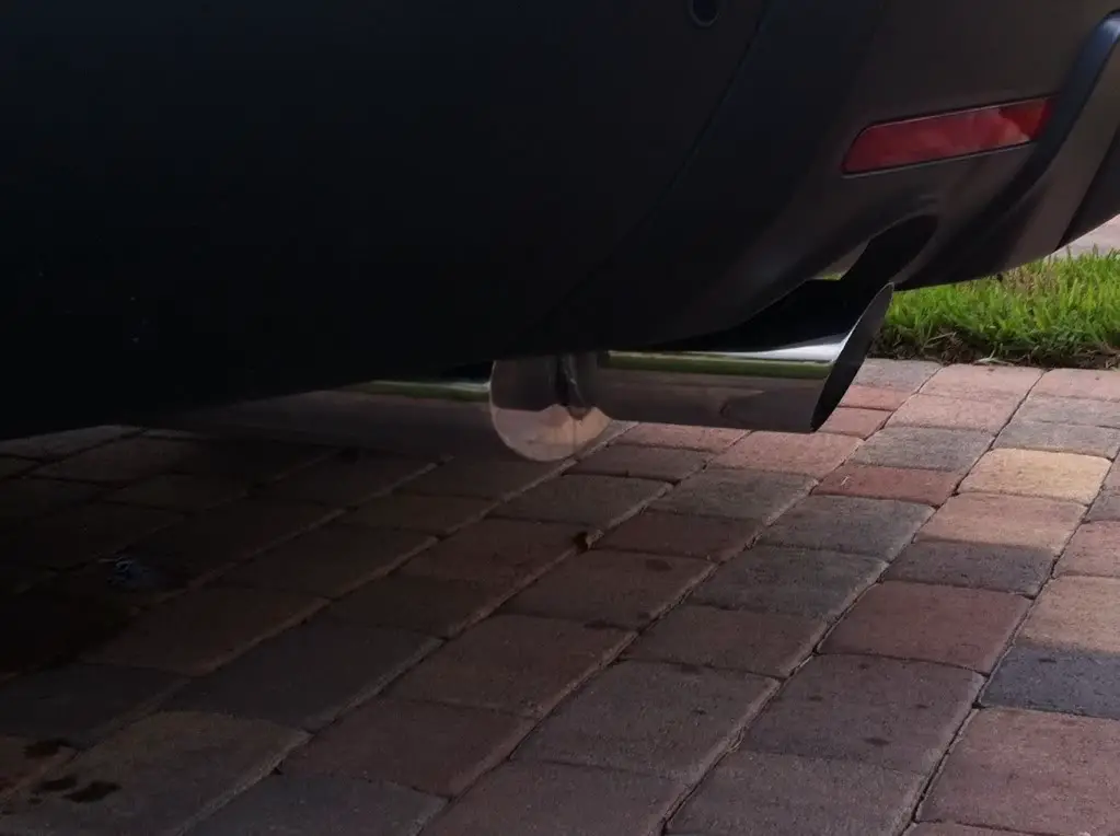

So thats my hasty initial impression of the exhaust. Now all we need is for someone to comment on the Magnaflow....which by the way I enjoy the tips better on my CGS than the magnaflows... Its like this, OEM tips equal Magnaflow tips..CGS tips are more pronouced and truck like than short and stubby.
Do you guys thing the tips are a little low? Also

Yes, from the pics, IMO... The tips are hanging too low... I'd prefer to hang like stock.
Also...from pics, does the left tip really stick out further than the right tip? If so hope you can adjust cause that would bother me.
