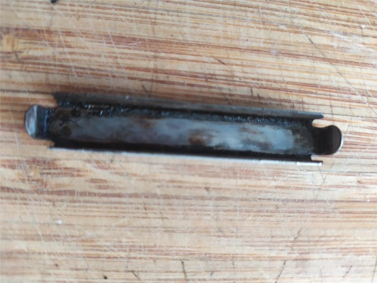

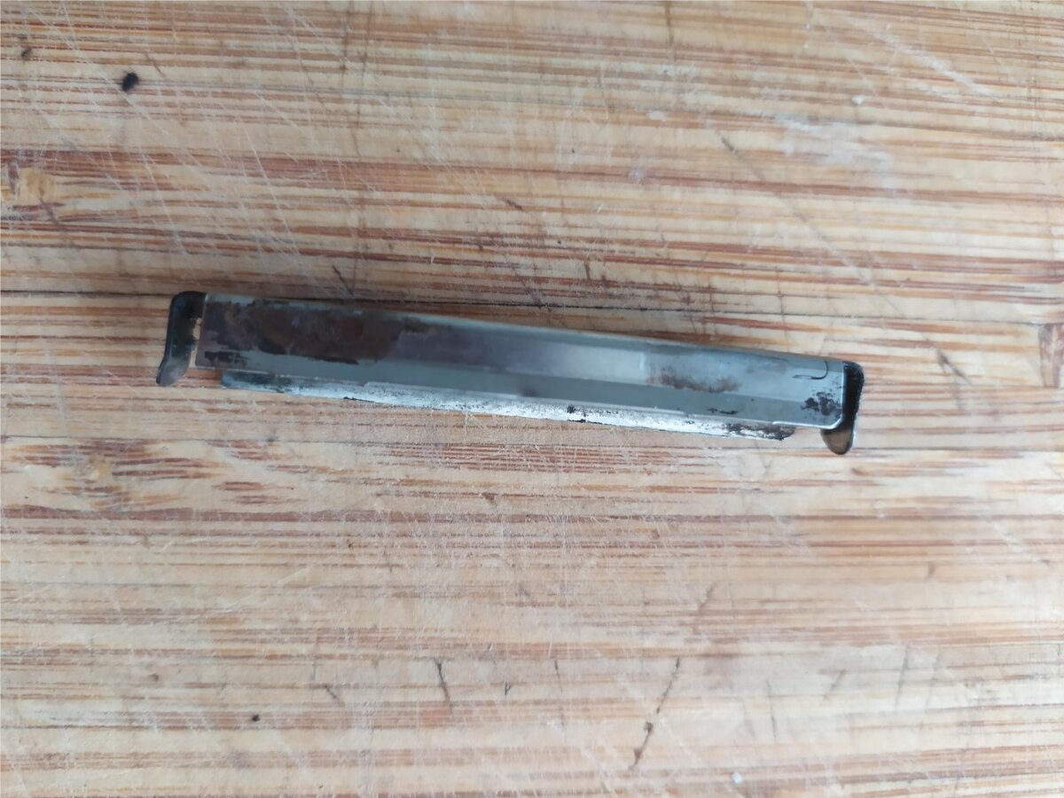

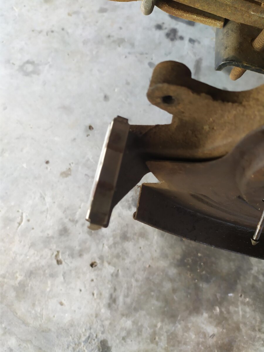

I appreciate all your stress and I feel I am getting there. I have tried 6 Brake suppliers and two Wreckers to locate and purchase the Calliper "Sliders". The age, not a popular car and the lack of knowledge of it by the local mechanics, all meant it impossible to trace a supply. I found something on eBay but it was in a packet and had little description. New or used it does not matter, single or double does not matter.
You can see I finally have worked out how to transfer photos through my Android phone to my iMac and then to the Forum. The last picture is the metal slider on the holding platform for the calliper.
Unfortunately I have been informed that the calliper will not work properly without both sliders so without it I cannot complete the repair & installation of my Diff

Abutment clips.
Why are those unusable?
Naw, it’s my bad, it says you need both very clearly.

Brake "hardware kits" are inexpensive and usually stocked in most U.S. auto parts stores. Are Explorers that uncommon down under?
1997 FORD EXPLORER 5.0L V8 Disc Brake Hardware Kit | RockAuto
Explorer has a nickname of. "exploder" here with mechanics, gives you an idea. We are pretty tough on our 4x4's here. Mine is 4litre 6 cyl manual.
Thank you so much for giving me the proper description to use . The minute I used that description in eBay an Ozzie supplier came up with a kit for AU$ 50 including express delivery from Melbourne Victoria. The magic word was "kit" and supplies new boots and sliders for two Callipers. Guys I am moving forward again, Thanks to you all:D
