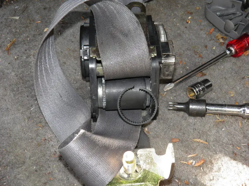

First this is the driver side of a 93X. My problem is that the belt was getting harder and harder to pull out and needed a lot of help retracting. I looked on here many times for help and didn’t find much except it is a common problem. I took it apart (now I say apart I should note I DID NOT take the retracting mechanism apart NOT NOT DISASSEMBLE THE MECHANISM) a couple times for cleaning & silicone treatments. But could not fix it I finally took the mechanism out and took a good look to see how it functions. I found there is a large idler wheel on the lower end of the mechanism that the belt wraps around. Now on that wheel there is a rubber sleeve (see photo) on top of the steel roller. What had happen is the rubber sleeve became loose and slid to one side acting as a brake. I would push it back and the belt function like new for a short time then the rubber belt would again shift to the side and bind. What I did was cut off about 1/8” of the belt pushed it to one side put some thick CA (crazy) glue on and put the belt back in the center. Now if you use CA be careful you have to know how to work with it. It dries very fast and is not forgiving don’t get it on your seat belt.

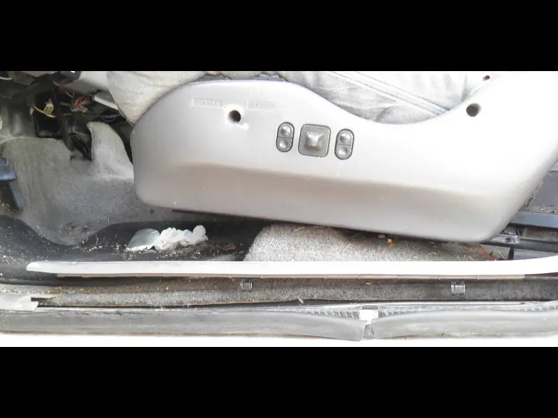

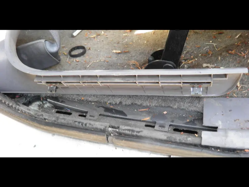

Take off the molding on the floor there are 3 screws one in front and 2 up on the post. Note where the clips are in the photo this will help you where to pry.

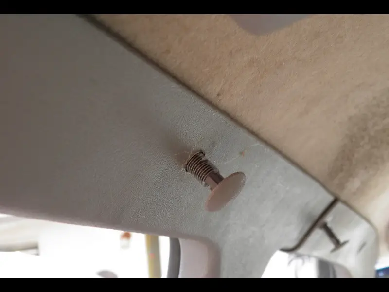

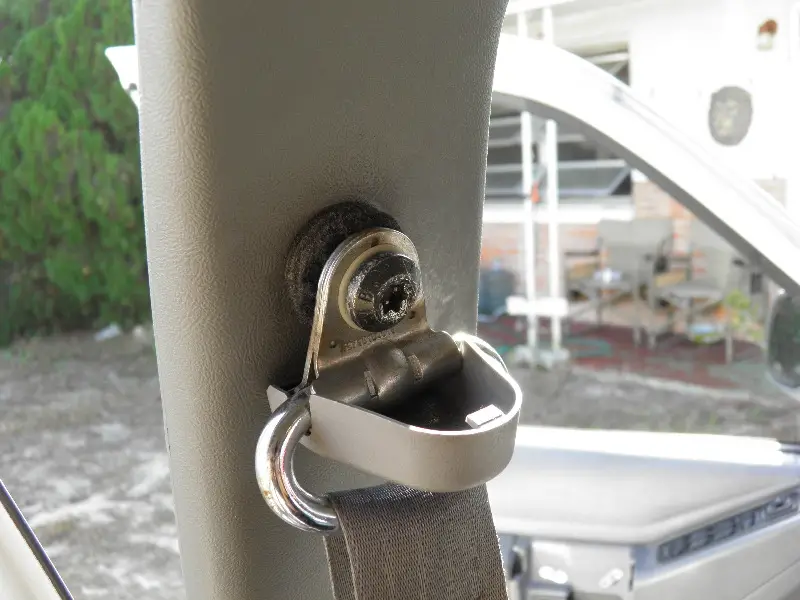

Next unbolt the top of the seat belt T-50 TORX bolt. Then pry out the 2 push-in connectors then unscrew the 7/32 bolt in the hanger hook. Now you cab remove your top molding.

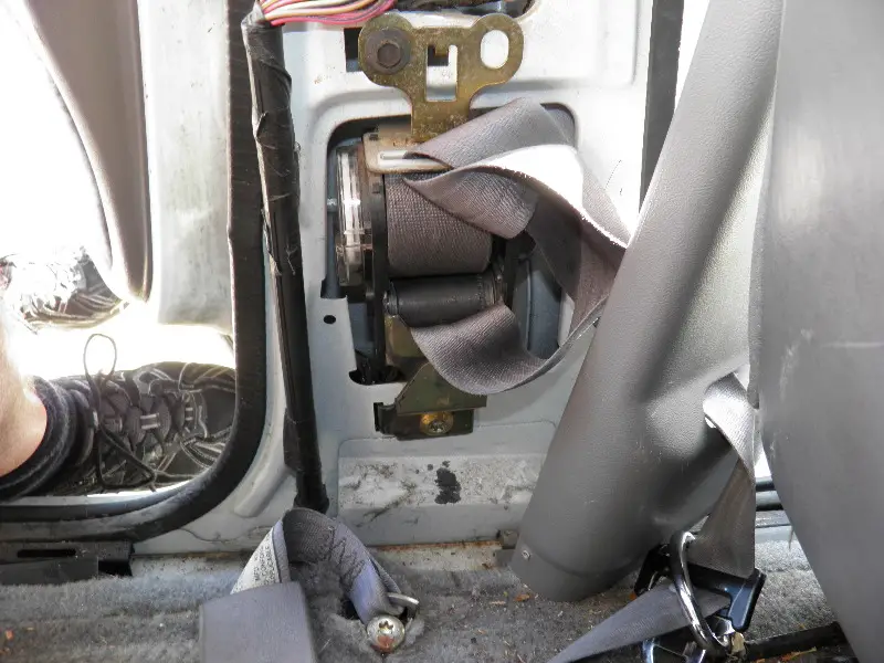

Here you see the mechanism in place. Note where the belt anchors to the floor. I put a slight slit in the carpet so I could get to the bolt easer. Unbolt the anchor feed your belt through the molding.
Now un bolt your mechanism there is a 10 mm bolt on top and a TORX T-50 on bottom. Again WARNING DO NOT DISASSEMBLE THE MECHANISM. You can work the belt but you have to hold the mechanism as it sits in the vehicle or it will lock on you. Now you can see the rubber belt on the lower idler roller. If it has slid to one side that is probably your problem at least it was mine. You can see the piece I cut off and then glued the rubber sleeve in place.
