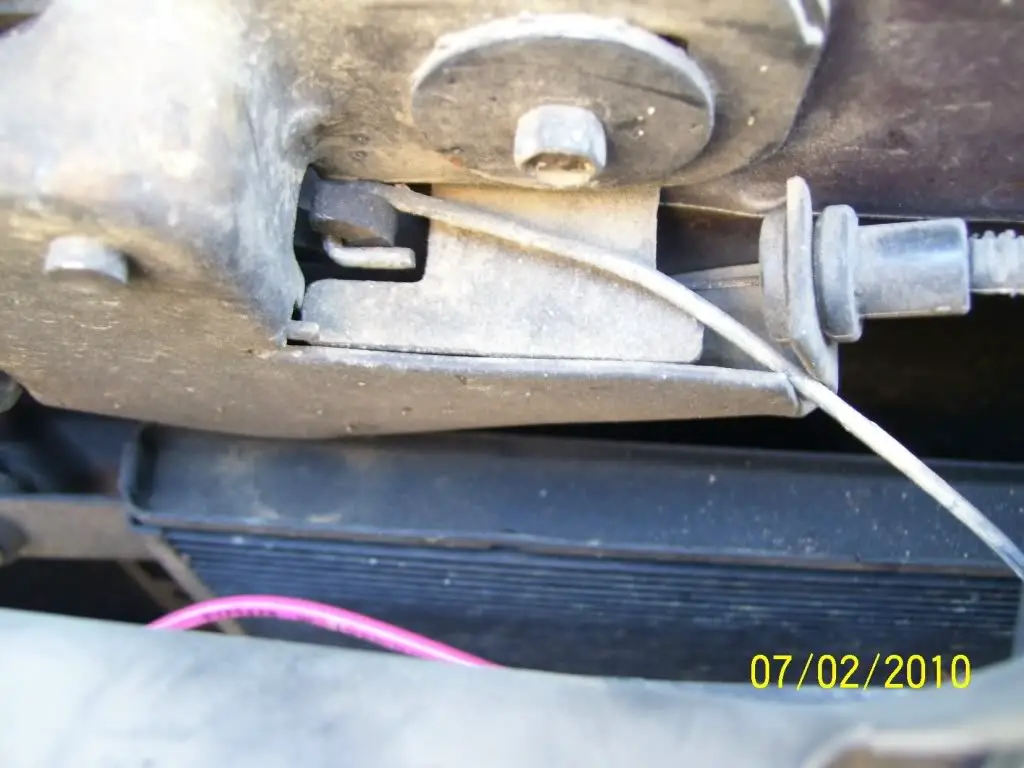

Simple as they come right here folks.
I had a problem awhile back with the cable sticking and getting harder & harder to pull to release the hood. So.....not wanting to ever get stuck in a bad place with no way to open the hood in an emergency or what not, I came up with this.
Using the handle from a 1 gal paint can, it was installed on the release tab on the hood latch. The bend for the tab is already made to fit perfect on the tab. Simply feed the wire through the grill to the tab, loop it around the tab, push it down with a screwdriver or something similar, and pinch it closed with a pair of needle nose pliers.
I bent the other end to make a loop handle and tucked it in the grill so it didn't stick out too far, but where I can grab it easy. A simple tug on the wire, and "POP" goes the hood :)
This has been in use for over a year and works the same as it did the day it was installed.

Look at the top pic. That tab the wire is hooked onto is the release for the latch. You can try to move it to the drivers side direction with a screwdriver or a pry bar with an angled end on it. Not going to lie, it wont be easy to reach, but it is doable.
