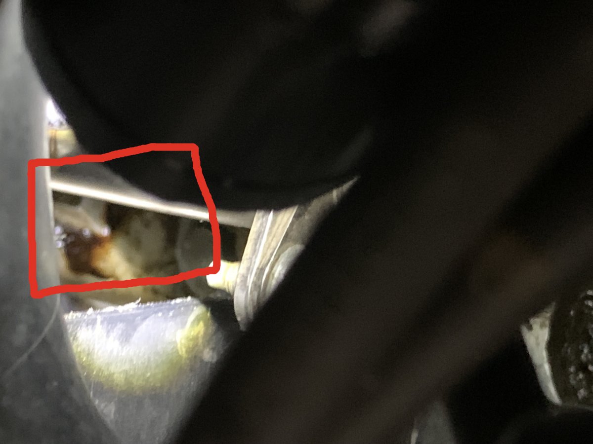

Back in December of 2022 I replaced the fuel rail sensor on my 2005 Explorer with information from this forum and a thread I started which I have linked below. I used a new gasket when reinstalling the intake manifold and tightened the bolts from the middle one to the outside ones gradually increasing the torque specification to 8 ft-lbs or 89 inch pounds. The car runs well and I have no codes. However, at certain RPMs I hear what I think is a very slight vacuum leak. And recently I noticed a little oil residue on the engine below the intake manifold.
It is possible I did not tighten the bolts enough. My question is if I re-torque them do I simply start the procedure again at 8 ft-lbs or do I loosen all of them and start over from scratch? The photo of the engine bay is for reference as to where the close up photos show the oil residue.
