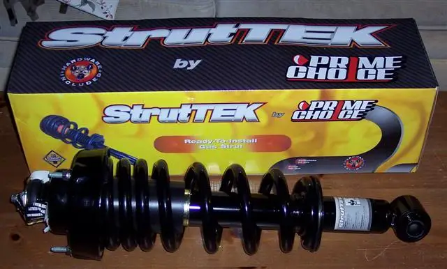

Both my rear springs were broken & my front struts were leaking when I bought my Ex in Feb 2010.
Now I'm running the StrutTEK's on all four corners and have nothing but good things to say about them! The ride is awesome and the price is right. I can't compare them to the original struts since they were FUBAR when I bought my Ex.
The rears were installed on 11/29/2010 & the fronts were installed on 2/20/2012.
BigRondo, I just read one of these posts that says the Struttek lifted the Explorer. Is that what typical experience is? I do not want to lift mine but was about to order a set of Strutteks (rears are back order right now BTW) and the write up about lifting made me stop. Please others that installed Strutteks chime in as well on whether they settled. Thanks
