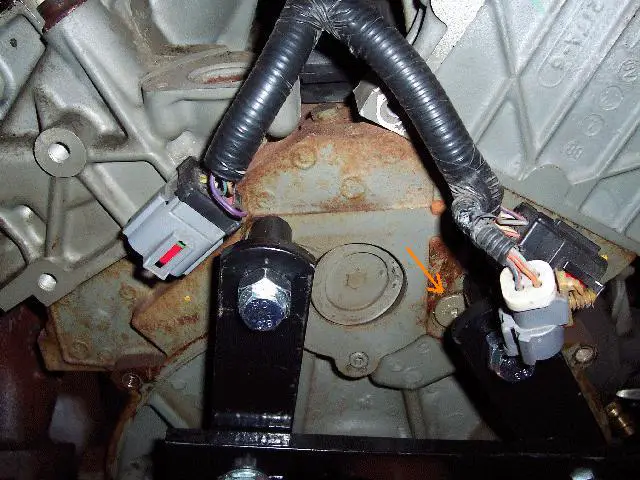

The rear cassette guide cannot be replaced without separating the transmission from the engine block. The cassette mounting bolt and jackshaft rear sprocket retaining bolt are located under the transmission.
