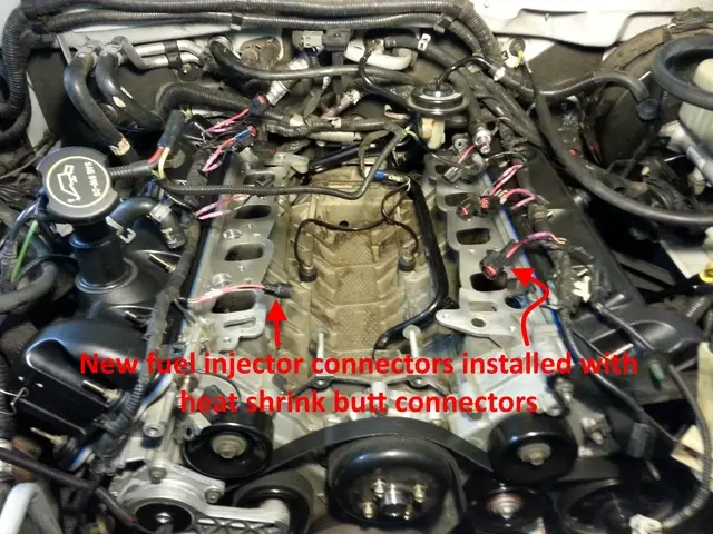

Even though I was very careful when unplugging the fuel injector connectors by gently pushing the plastic tabs I noted that three of my fuel injector connector tabs where broken. It's possible the plastic gets very brittle over time with heat so be very careful or else you'll need to come up with a way to hold the connectors on your fuel injectors. I decided to replace all of the connectors at a total cost of about $15. I used heat shrink butt connectors that keep out moisture.

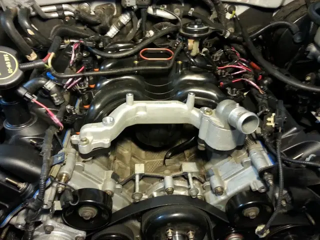

I used the Dorman instructions to torque all the bolt and in sequence.
While I was in the area I replaced the timing chains and the valve cover gaskets. The vehicle started right up, without hesitation and idled smoothly. The next day I drove the vehicle 500 miles without incident. My gas mileage went way up from where it was prior to the intake manifold replacement. At 75 - 80 mph I got around 19.5 mpg which isn't bad for a 4x4. At 55 mph I was getting 21.5 to 22 mpg.
