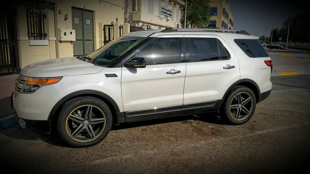

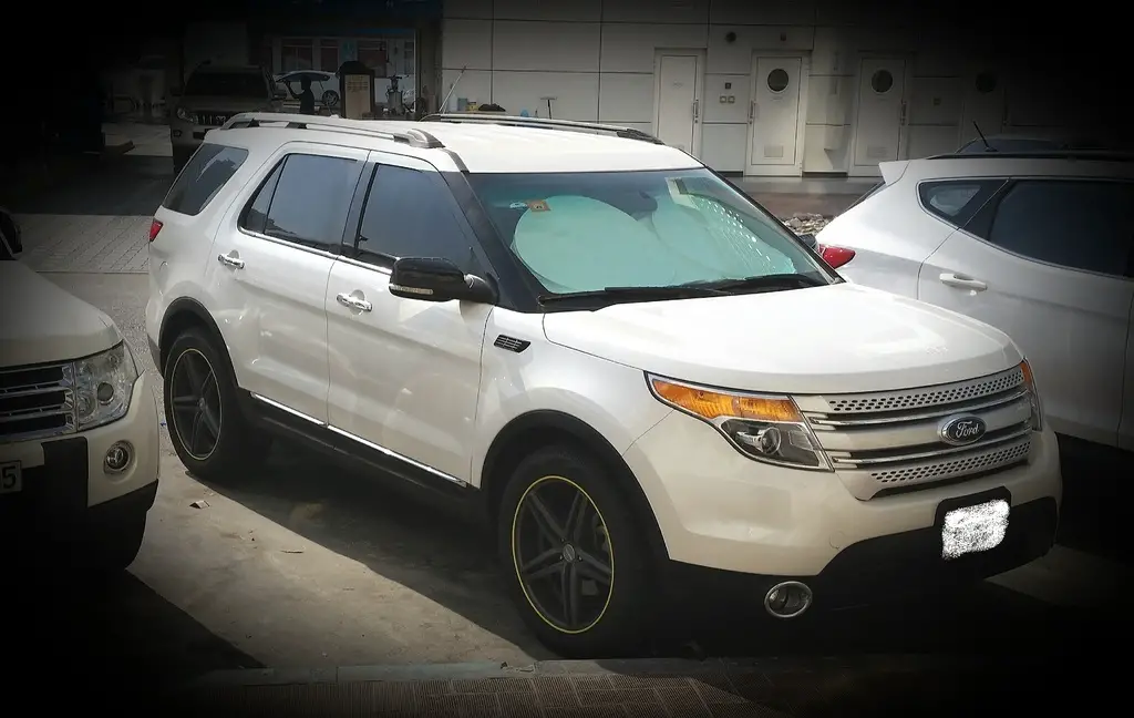

i'm driving FWD and have aftermarket wheels - 265/50/20 and they are way better that the stock 18"
Now we are getting somewhere. Looks like you have plenty of room there. Do you think 265 55 20s on factory 2014 limited wheels would fit without rubbing?
new stock tires are about 30" in height, the 275/45s are about 1/4" total shorter, but do give you more width to protect the rim. 255 to 265 isn't much of a change and 275/50 is about 3/4" too tall. Either way I would get some with a rim protector, click the link. http://www.tirerack.com/tires/tiretech/techpage.jsp?techid=149
I did look at the 275 45s but correct me if I'm wrong, isn't that actually a slightly lower profile than the 255 50s that are on it right now?
i think it will fit, will give you closer look
and even 60 will fit on the rear. i've also tried wider tire up to 285 and it didnt rub on the suspension parts.
