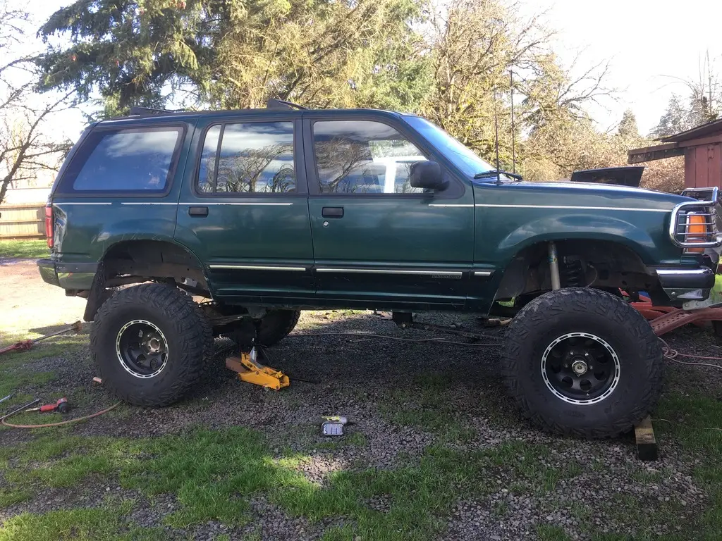

Iv got two engines I want to build. For my 93 daily I plan on doing a boosted engine, currently reading a 17 page long thread, on page 9 after 4 hours lol. I already have a 93 block with new cast heads with 988 springs, SI valves, and bronze guilds. The block has 95+ ohv dished pistons, 422 can, ARP rod bolts and came with ARP head studs as well. The 8:1 CR should work well with some boost. For my wheeler rig I want a HC engine at like 10:1 and all the works, but I need the 95Tm heads to make that build happen. Here's a few pics. 93 daily stock 5 speed. 94 10" lift 35s 5 speed. I also have a 92 parts rig and a 98 daily 5 speed as well.
