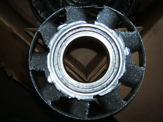

I was only joking about them never making noise. That one pictured was making some horrendous noises, but it still worked somehow. Dont just rule it out because someone said they dont make noise, anything with moving parts can make noise.
Gotcha:thumbsup:
