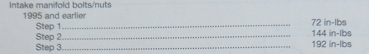

In the book it shows the torque for the lower intake but I'm dumb and don't fully understand
So it shows 72 in-pounds for first step
Is that 72 inches or is it 72 pounds?
Welp It clearly shows inch pounds in the picture
You can convert inch pounds to ft pounds
. If your torque wrench is only foot pounds
1 foot pound = 12 in pounds
If I knew what in-pounds meant I wouldn't have asked. I'm not mechanical inclined at all so here I am
I appreciate the clarification and help.

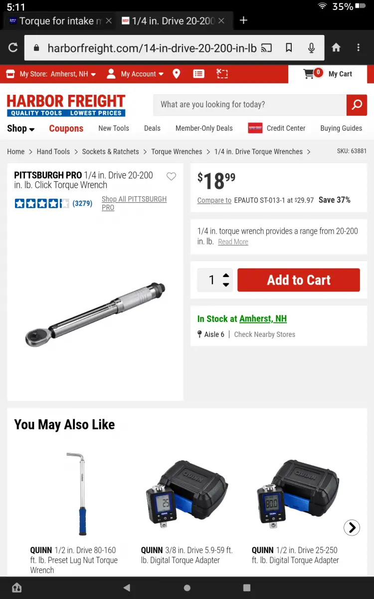

Torque wrench come in a few varieties drives 1/4, 3/8, 1/2. Inch pounds, foot-pounds.
For those values , you would uses a 1/4 drive with a inch pound value settings on it. The torque range on the wrench might go up to 200 inch pound.

The real, useful answer? Buy a torque wrench calibrated in the units you need. Generally, if a spec calls for inch pounds, I like to use a small inch pounds wrench. You can do the math to convert, but a larger wrench can often easily overtorque a small fastener within its margin of error. That’s how you get broken bolts.
