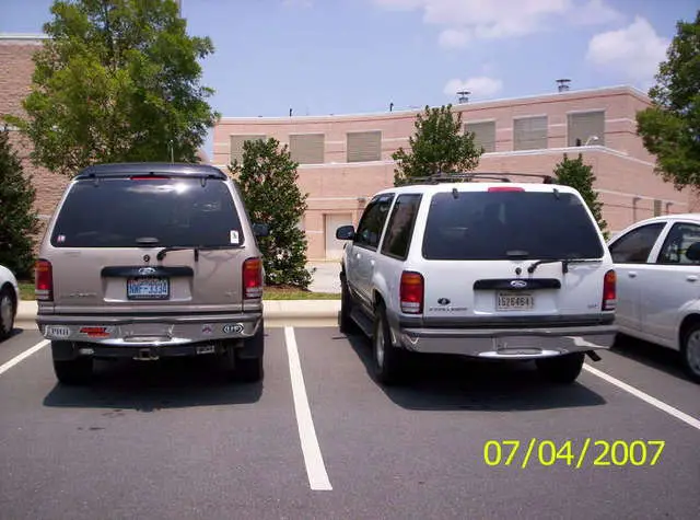

Here is the lift that I got by doing this on my '98 Sport 4x4 (3" rear, 1.5" TT):
With the 285/75/16 BFG AT's and Fiberglass fenders:
