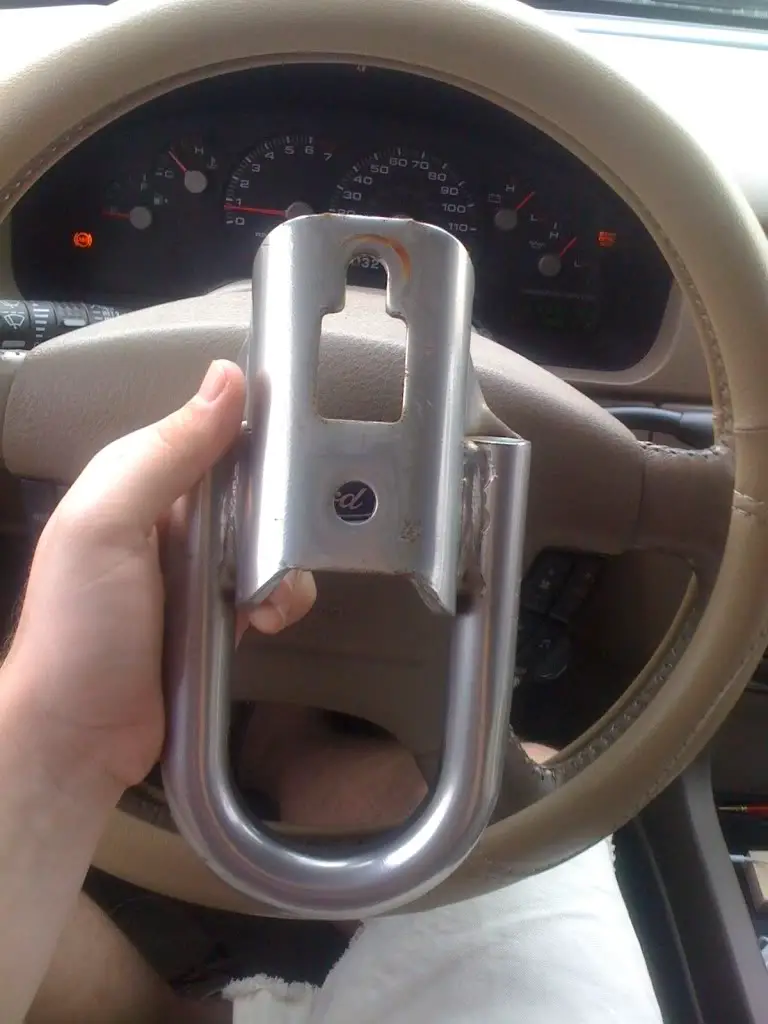

For those of you who have installed the F-150 tow hooks on your Ex, were they this GIANT?
And does anyone know the bolt size I'll need?
i got them on my ST and they are awesome! unfortunately, i got stuck in a really bad spot, and had to get pulled from a bad angle and now im down to one tow hook. the stampe on the frame that the tow hook was mounted to snapped before the hook, now i have to figure out how to get it welded back on. but the tow hook itself is a beast. just make sure you get grade 8 bolts. i dont remember offhand what size i use, but i think it might be 5/8
yeah theyre pretty big and weigh a lot more than expected. that looks different than mine however, but mine came off a 99 expedition...
I have to other style but yes those things are giant pictures dont do justice i wasnt expecting mine to be as big as they are but i love them, they are a great addition
I went down to home depot and got 4 of each. 1/2"x2" Grade 5 hex bolts & 1/2" Grade 5 Serrated Hex Flange Nuts. Some say use grade 8 which yes you could.

I held it up to the opening and I guess it is the right size.... I just didn't expect them to be damn near the size of my steering wheel. They are going on after I do my BL.
