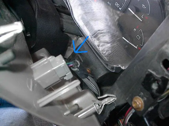

Never mind, pins don't line up. this is the plug I'm refering to
It looks like it fits into the non-ford end of that plug, but that is the end that is supposed to go to the controller.
This is really starting to eat away at me. I'm a little suprised that there isn't more information on either of these plugs online given the age of these vehicles.
Problem solved, the plug on the passenger side is part of the harness for the rear bumper sensors in vehicles with backup warning. The plug mentioned in the previous post connects to the cab interface. One vehicle harness, lots of options.
