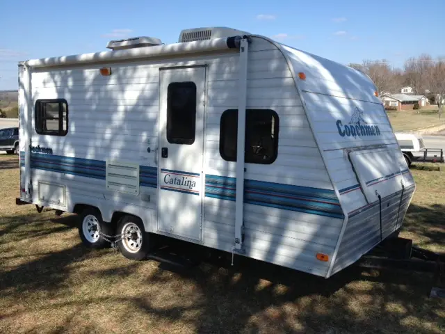

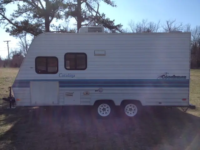

Hi again guys. I have found one (been looking for weeks to learn price ranges) that I am interested in..and can afford (haha). I do not have the weight of it yet (the guy will go look in the daylight tomorrow).
I can use dads F-150, but hate to borrow. :confused:
1996 Coachman Catalina Ultralight, 18ft, bumper pull
It probably will not pan out, but here are a couple of exterior pics.
Nice, your expo should have no problems hauling that with a weight distribution system. Also, if you do a lot of high way driving look into a sway control bar, weather you use the F150 or not they make hauling a dream! Keeps the trailer inline with the truck and helps keep things under control when you have to make an envase maneuver.
I don't have one on mine as its built into each end of my torsion bars. Where it says reese back by the battery, those act like brake pads to keep the trailer from swaying. I can haul at a nice pace with no problems with sway. Again all recommendations to make your hauling experience easier as you shouldn't have as many problems with sway as its a tandem wheel setup.
Looks like its about 2860lbs dry, which is well within your hauling rate for the expo! Pulled specs from here http://www.nadaguides.com/RVs/1996/Coachmen
