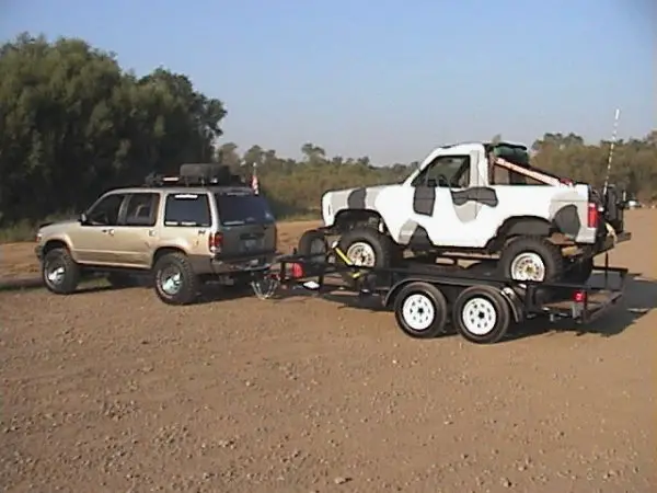

You don't have to switch over to the four door leaf pack to put an add-a-leaf set on, but it will help. You can also look into a set ofDead Link Removed helper springs... they have full time and part time ones. I have the add-a-leafs on mine and tow a 14' tandem with my B2 on it and I loose about 4" when I hook the trailer up. The add-a-leafs help alot and the Rancho RS5000s help keep me from bounceing with the trailer on too. I am getting a set of the Helwigs and that should help even more.
