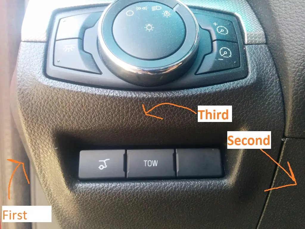

So I just completed my haul using Uhaul's largest available enclosed trailer (6'x12'). I don't have the factory tow package but am using an aftermarket hitch and installed the tow/haul button. I do not have an oil or transmission cooler. Trailer itself weighed 2000 lbs. I can only guess at the weight of what I was hauling but I'd put it somewhere between 800 and 1000 lbs. Drove about 40 miles overall with the trailer loaded. The Explorer performed flawlessly. At no point did it feel like it was struggling. The tow/haul button kept it in the right gear. I wouldn't take that amount cross country without an oil cooler but for what I was doing, it worked out great. Hope this helps anyone else in a similar predicament.
FYI: To install the tow/haul button, remove the trim to the left side of it by pulling it towards the door, remove the trim to the right of it under the steering wheel by pulling it straight out, and THEN remove the trim around the buttons. If you do it in any other order you'll most likely bend the trim or break a tab due to how they align with each other.
