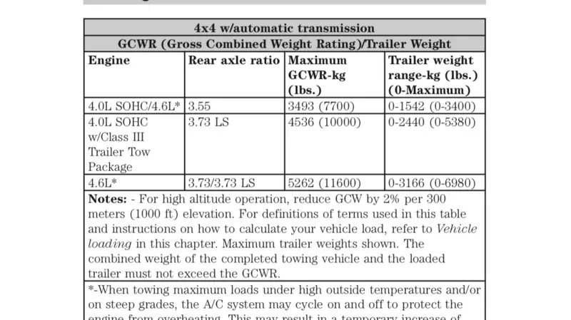

Refer to the vehicle spec sticker in the door jam. Look up the axle code and use that with your manual.
If you have the 1 1/4 inch hitch it’s not up to the job.
Looking at your manual your towing limit is 3,400.

Need to know which axle you have. If it's the 3.73 it's worth getting the Curt aftermarket hitch for it and it will tow it just fine. Just don't forget to turn the overdrive off.
